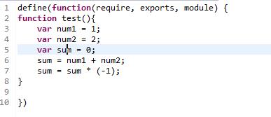

after version Oxygen, if there are just common functions in js file, the highlight of all occurrence of selection variable works fine. but if we use define it as a module, then the highlight does not work.
no problem before version Neon.
let me explain it by example:
1. just a common function in the js file, works fine:
index.php/fa/35068/0/
2. put it in a define module, the hightlight does not work:
index.php/fa/35069/0/
we can see, the cursor is in the variable sum, but it does not highlight occurrence of the variable.
3. And I found that, from verion Oxyngen, the outline of js file shows define as the top level:
index.php/fa/35070/0/
4. before version Neon, the outline shows the function name only:
index.php/fa/35071/0/
if it can works as the version Neon (and before) that hightlight all occurrence of the selection variables, it is very convenient to check variable when writting and reading the javascript code.
