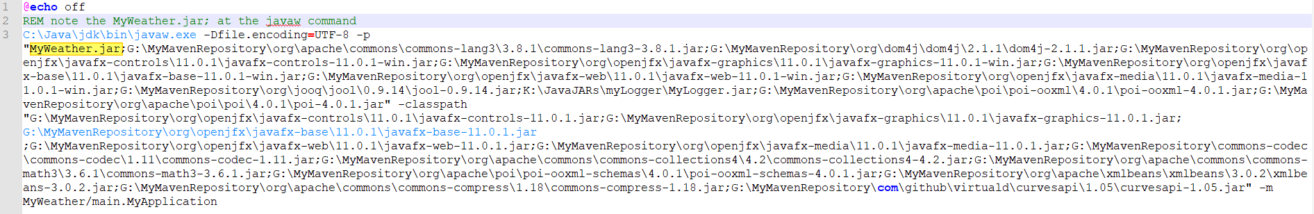

Then I generated a Runnable JAR from the same "launch configuration" .
When I click on the generated jar the program screen appears but after a new seconds the program exit by it self.
Things that I did.
- I override the stop() method in the Application class (I add a log entry to a file). stop() was not activated.
- I exported a regular jar file . In order to make it run I created a batch file:
index.php/fa/34620/0/
The batch file is based on the "launch configuration", The only difference is the use of the generated jar MyWeather.jar.
This is a working solution , But I am not happy since I prefer the Runnable JAR approach.
Has any one had similar experience ?
Regards.
