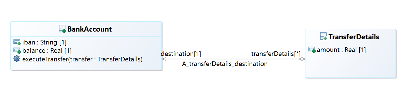

For example, let's suppose I have a class BankAccount with an operation executeTransfer(transfer: TransferDetails). A TransferDetails object contains the amount of money to be transferred and the destination of the transfer. How do I specify, e.g., that transfer.amount cannot be more than the current balance of the BankAccount?
I can create a preCondition for the executeTransfer() operation, but how do I access the attributes of the transfer parameter?

Thank you for your response. Here is a class diagram of the example I talked about:
index.php/fa/34314/0/
I want to use a precondition for the executeTransfer() operation to make sure that the amount that should be transferred is not greater than the balance of the bank account.
I tried this:
self.transfer.amount >= self.owner.balance
Then I realized that, even though it is a precondition for the executeTransfer operation, the context of the expression seems to be the BankAccount class.
So I tried this:
self.executeTransfer.transfer.amount >= self.balance
This yields the following error message when trying to validate the model:
"Parsing error for Example::BankExample::BankAccount::executeTransfer::preExecuteTransfer::self.executeTransfer.transfer.amount >= self.balance:
The 'executeTransfer::preExecuteTransfer' constraint is invalid: 'self.executeTransfer.transfer.amount >= self.balance' 1: Unresolved Property 'Example::BankExample::BankAccount::executeTransfer' 1: Unresolved Operation 'OclInvalid::>=(Real)'"

Re: Specify Constraint for Parameter of a UML Operation [message #1798117 is a reply to message #1798116] Mon, 12 November 2018 16:06 Go to previous messageGo to next message
The precondition executes just the same as the operation.
Yes self is the context class. If you want to refer to a parameter, do not prefix it with self, just as in Java you would not use this.argument to access a function argument.

Sorry for my late response.
I tried out your suggestions today and with your hints I was able to figure out the correct statement:
Thanks for your help!
