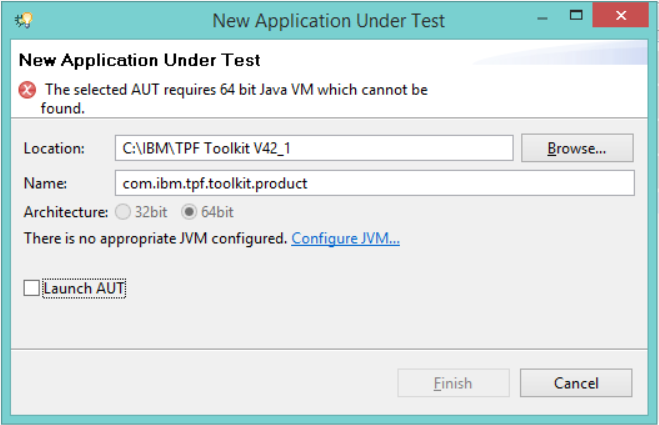

I was trying to test an application using RCPTT. When adding the location, it checks the plugins - but at the end it says "The selected AUT requires 64 bit Java VM which cannot be found." Added the same as screenshot.
index.php/fa/33377/0/
Could someone help me to resolve this and add the applications successfully for test.
Thanks in advance!

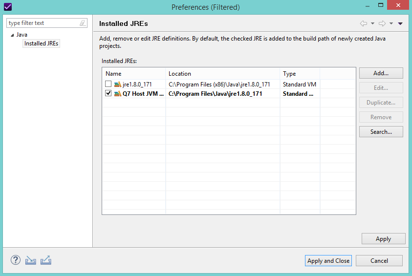

what happens when you click on the "Configure JVM..." link and add your 64bit JVM installation there?
Markus
Re: Unable to add an application in RCPTT [message #1792203 is a reply to message #1792182] Thu, 12 July 2018 10:34 Go to previous messageGo to next message
It already has the JVM selected. Below is the screenshot when I click on the 'Configure JVM'
index.php/fa/33381/0/
Re: Unable to add an application in RCPTT [message #1792255 is a reply to message #1792203] Fri, 13 July 2018 08:06 Go to previous messageGo to next message
this seems to be the x86 edition of the 1.8.0_171.
Try to download and install the x64 edition of the JRE which then should be suitable for 64bit.
Best regards
Markus
Re: Unable to add an application in RCPTT [message #1792559 is a reply to message #1792255] Thu, 19 July 2018 10:08 Go to previous message
Thanks a ton! It worked. :) I already saved the x64 edition of JRE sometime ago, but failed to add its path as default one here. Now I'm successfully able to add the new application.
