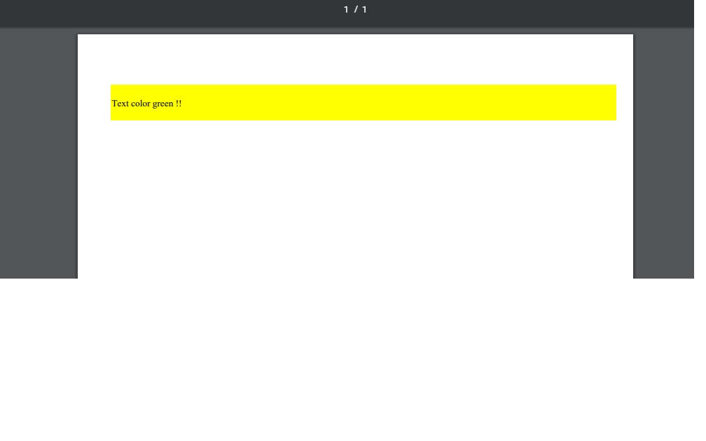

We have a requirement to generate pdf with dynamic html with custom CSS styling inside an text element. That is text element will have dynamic html as content in text-property.
I have tried the "Use CSS File" option.
The external styles are available. However I can only select one style for the outer text-element and all other external styles are not applied to text-content html except the one selected.

I would like to know if there is a possibility to include entire css stylesheet to text-element instead of only one style. Or any other way in which the external stylesheet can be made available for text-content html.
