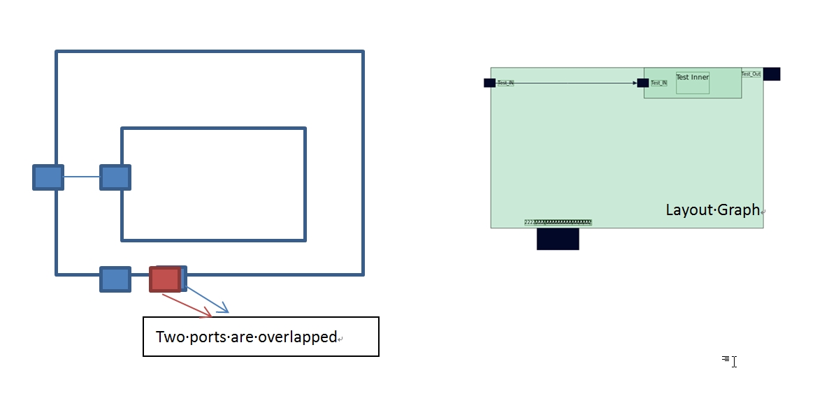

Hi Daniel,
Thanks for your replay.
I attach the screenshot and our ELK version is V0.2.2.
index.php/fa/33160/0/
More information as lee lucky said.
Nicholas Kong
[Updated on: Tue, 19 June 2018 03:17]

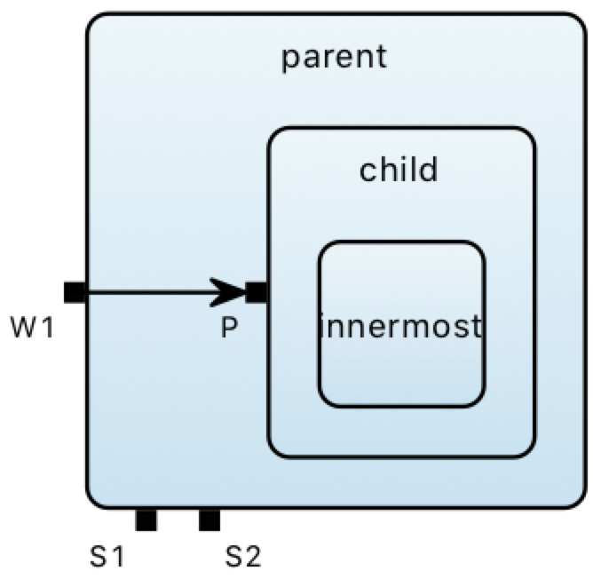

Nicholas,
thanks for providing more details. I've tried to reproduce your graph as follows:
hierarchyHandling: INCLUDE_CHILDREN
node parent {
	portConstraints: FIXED_SIDE
	port W1 { ^port.side: WEST }
	port S1 { ^port.side: SOUTH }
	port S2 { ^port.side: SOUTH }
	node child {
		port P
		node innermost
	edge W1 -> child.P
With the current version of ELK (0.4.0), this graph is laid out like this:
index.php/fa/33170/0/
Either I have missed some particular configuration that leads to the problem you observe, or it is due to a bug in 0.2.2 that we have since fixed.
Cheers,
Chris
