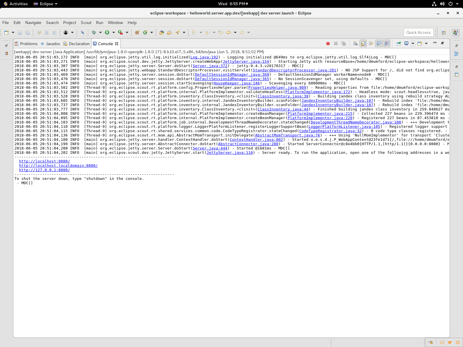

Re: Fresh Eclipse Oxygen w Scout Install On Centos 7 [message #1790150 is a reply to message #1790143] Wed, 06 June 2018 05:45 Go to previous messageGo to next message
Typically, "Initialization failed" occurs when the UI part of the application has started, but the backend has not (successfully).
Make sure you have started both the UI and Backend launchers, and if the problem persists, please post the log messages from the Console View (using the little blue monitor icons to switch between launched applications) in Eclipse.

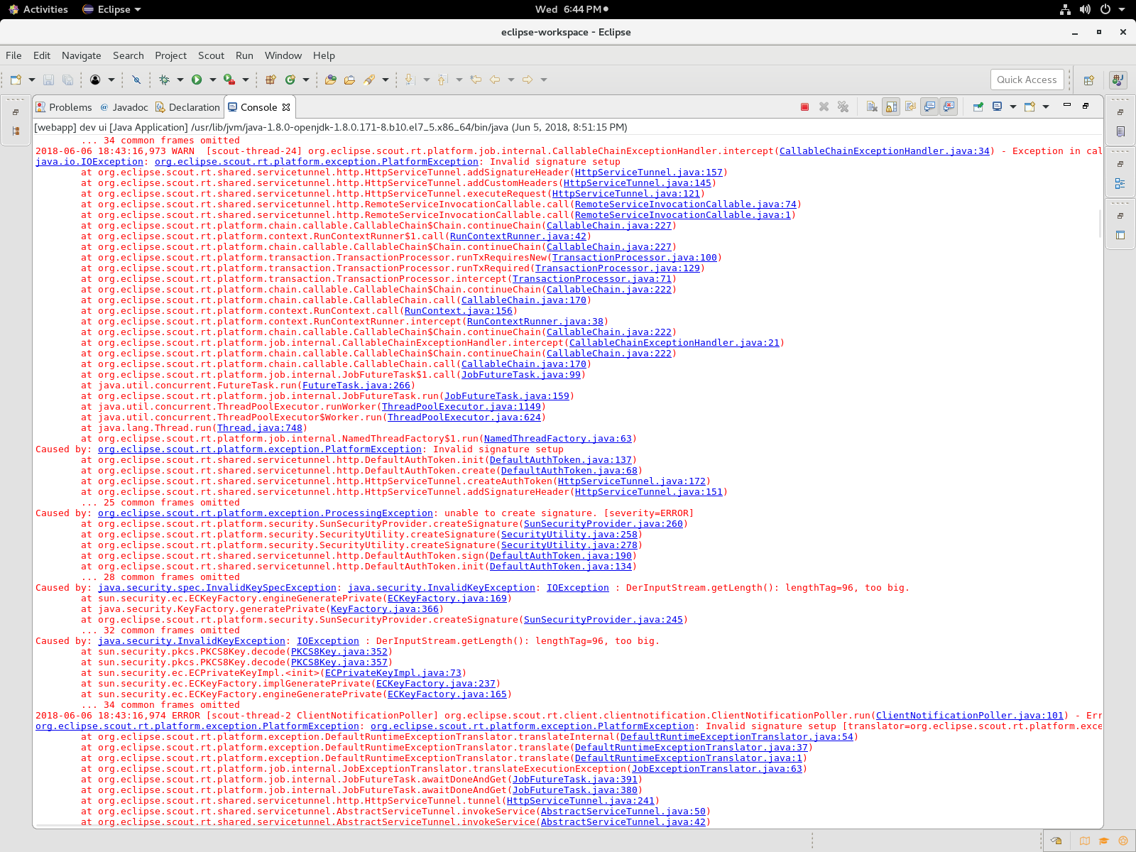

Re: Fresh Eclipse Oxygen w Scout Install On Centos 7 [message #1790203 is a reply to message #1790150] Wed, 06 June 2018 22:47 Go to previous messageGo to next message
Attached is the console for the client which is showing the errors.

Re: Fresh Eclipse Oxygen w Scout Install On Centos 7 [message #1790214 is a reply to message #1790203] Thu, 07 June 2018 06:57 Go to previous messageGo to next message
The available implementation of ISecurityProvider uses Sun specific class (SunSecurityProvider). You seem to use a different JDK. See https://www.eclipse.org/forums/index.php?t=msg&th=1080131&goto=1775072&#msg_1775072 for further information.
Verify that the properties
scout.auth.publickey (config.properties in *.server.app.dev) and scout.auth.privatekey (config.properties in *.html.app.dev) were successfully generated when creating the Scout project.

Re: Fresh Eclipse Oxygen w Scout Install On Centos 7 [message #1790409 is a reply to message #1790375] Sat, 09 June 2018 19:48 Go to previous message
The one you posted in the other thread means that the private and public key pair couldn't be created successfully. To generate them manually, run SecurityUtility as described by Mat in the post I referenced before. To run this, you either need to run it with Oracle JDK or implemented the ISecurityProvider yourself. The SDK couldn't create them because you are using a JDK that doesn't have the Sun specific classes.
