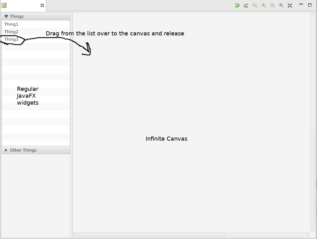

I've attached basically what I'm talking about... the list on the left is just a JavaFX ListView... I want to drag it on to the graph on the right and have it create a node in the graph.
index.php/fa/32621/0/
if I make the different parts of my graph listen for javaFx drag drop related events it sort of works...i get notified of the drop event but but it is quite disconnected from the GEF MVC framework IOnDragHandler... so I'm wondering what the best way is connect them...
