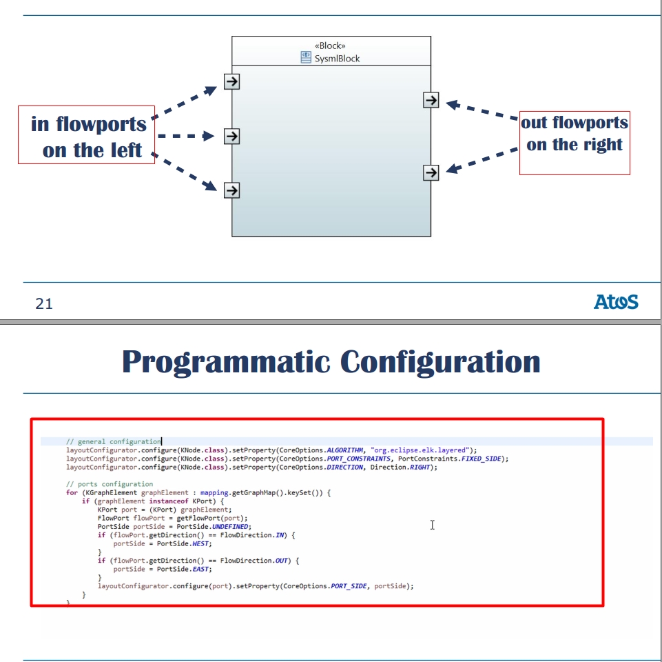

But some times, I want to customized some BorderNode position (ElkPort), based on the semantic model information IN/OUT. It is hard to do.
I find a presentation 'introducing the Eclipse Layout Kernel' by Christoph Daniel Schulze, which includes the same example. As following description:
index.php/fa/32587/0/
But this example code just is partial code. And then I follow the 'Advanced Configuration' tutorial, find I can prepare the parameter before DiagramLayoutEngine. However, it maybe can not specify the layout option to corresponded semantic model element. (Because the mapping(LayoutMapping) can not prepared before the DiagramLayoutEngine).
Compare these, this information makes me confused.
1) What's the correct way to customized the layout, like using the semantic model information to impact the ELK? (like Daniel's presentation)
2) Is there any example/sample for ELK tool developer?
Thanks for your reply.
[Updated on: Thu, 12 April 2018 03:54] by Moderator
Re: How Customized ELK to fit Sirius application? [message #1785299 is a reply to message #1785293] Thu, 12 April 2018 04:38 Go to previous messageGo to next message
There are many ways to configure ELK layout. If you would like to reuse the code snipped that you posted, you could try the following:
  • Implement an ILayoutSetup (see e.g. GmfLayoutSetup) and register it with the org.eclipse.elk.core.service.layoutConnectors extension point.
  • In the Guice Module returned by your setup, bind DiagramLayoutEngine to a new subclass (e.g. CustomDiagramLayoutEngine).
  • In CustomDiagramLayoutEngine, override addDiagramConfig(Parameters, LayoutMapping) to add your configuration code.
protected void addDiagramConfig(Parameters params, LayoutMapping layoutMapping) {
    LayoutConfigurator layoutConfigurator = params.addLayoutRun();
    // Put your configuration code here
    super.addDiagramConfig(params, layoutMapping);

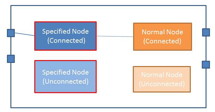

I want to use ELK to let some specified Nodes always on the left side, no matter them have edge or not.
How can I handle this scenario?
I try to use the 'LayeredOptions.LAYERING_LAYER_CONSTRAINT', but it does not met our opinion.
index.php/fa/32799/0/
  • Attachment: Capture.PNG
    (Size: 14.24KB, Downloaded 996 times)

If I comment "setProperty(CoreOptions.HIERARCHY_HANDLING, HierarchyHandling.INCLUDE_CHILDREN)", the exception will not show up.
It seems that there is something wrong with customizing port side with the property "HierarchyHandling.INCLUDE_CHILDREN". Can you give me some suggestions or guide about how to correct my customized layout ?
Thanks in advance and hope for your reply.
Re: How Customized ELK to fit Sirius application? [message #1787206 is a reply to message #1787122] Tue, 22 May 2018 02:56 Go to previous messageGo to next message
An exception like that is a bug. Please check whether it has already been reported at https://github.com/eclipse/elk/issues and create an issue if it's not there yet.
Re: How Customized ELK to fit Sirius application? [message #1787215 is a reply to message #1785293] Tue, 22 May 2018 04:14 Go to previous messageGo to next message
Deactivating greedy switch should help.
Nevertheless, it would helpful if you could share the the graph (in ELK graph format) such that we can debug the issue. There's a method 'exportLayoutGraph(...)' in the DiagramLayoutEngine to do so.
Re: How Customized ELK to fit Sirius application? [message #1794366 is a reply to message #1785314] Wed, 29 August 2018 11:33 Go to previous message
Nicholas Kong wrote on Thu, 12 April 2018 11:56
Miro Spönemann.
Can I use this ElkUtil.applyVisitors(graph, configurator) before the DiagramLayoutEngine.invokeLayout() ?
It looks different with 'Advanced Configuration'.
LayoutConfigurator configurator = new LayoutConfigurator();
// Configure layout options for a concrete graph object
configurator.configure(myVerySpecialNode)
    .setProperty(CoreOptions.INTERACTIVE, true)
    .setProperty(CoreOptions.PORT_CONSTRAINTS, PortConstraints.FIXED);
DiagramLayoutEngine.Parameters params = new DiagramLayoutEngine.Parameters();
params.addLayoutRun(configurator);
DiagramLayoutEngine.invokeLayout(workbenchPart, diagramPart, params);
Dear Nicholas. Can you share your code or explain where the workbenchPart comes from?
If I do "PlatformUI.getWorkbench().getActiveWorkbenchWindow().getActivePage().getActivePart()" to get my WorkbenchPart
it gives an error "No layout connector is available for the given selection blablabla.", basically because I have multiple Dialog windows (I guess...).
Thank you for your help.
