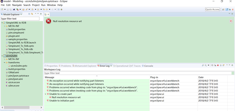

generating .qvtotrace file fails [message #1784609] Fri, 30 March 2018 06:56 Go to next message
The error log and my project's files are list in File Attachments in screenshot.
i do not know what i did wrong
Firstly,do i lost some files in project ? The structure of my project as picture 1.
uicm.ecore is meta source file,uilm.ecore is meta target file,GMail.uicm is source file,i want to generate GMailPSM.uilm as target file.
I find that the result of generate GMailPSM.uilm seems right as picture 2.

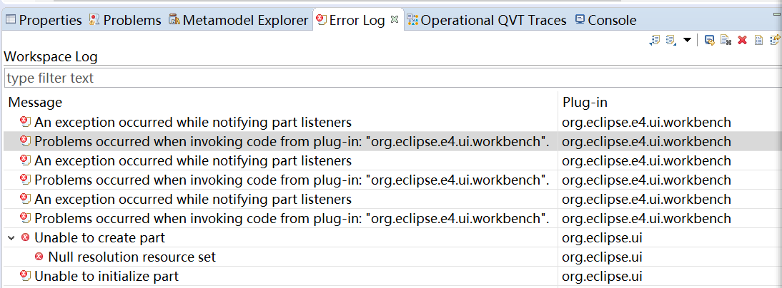

The error generated are as picture 5.The concrete messages are as follows:
An exception occurred while notifying part listeners,ects.

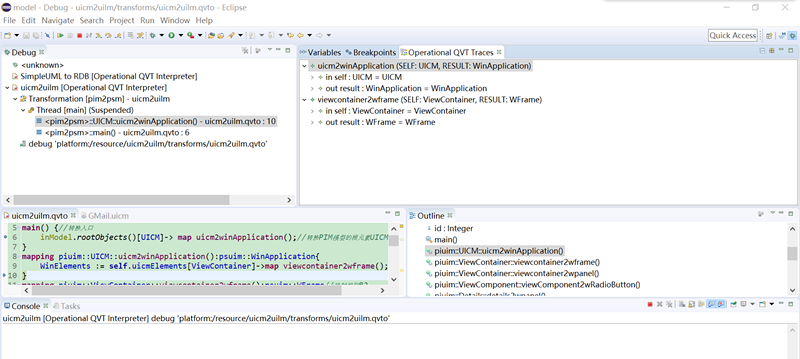

I want to add something
when i use debug run mode ,in Operational QVT Traces windows show the process and function it has been executed like picture 1.It looks seem true.
so i do not know what is wrong with the problem above
  • Attachment: 1.png
    (Size: 142.25KB, Downloaded 222 times)
Re: generating .qvtotrace file fails [message #1784614 is a reply to message #1784613] Fri, 30 March 2018 08:10 Go to previous messageGo to next message
I see no picture 1 or picture 2 just an Error Log that shows errors that could have come from any tool and have no obvious relationship to QVTo or a trace.
I cannot comment on the second message. I am not even clear whether you are retracting or clarifying.
If you have a real problem please express it clearly and provide a repro (zipped project) to demonstrate it.
Ed Willink

Re: generating .qvtotrace file fails [message #1784679 is a reply to message #1784624] Mon, 02 April 2018 04:10 Go to previous messageGo to next message
Hi,Ed Willink

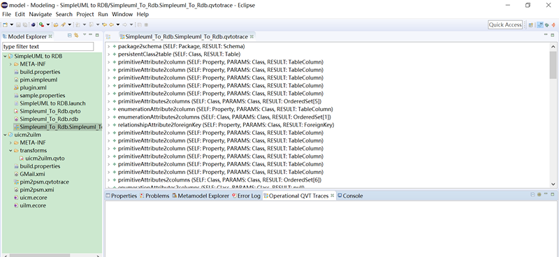

Thank you for your advice,I followed it.I delete those chinese charactors in annotaion and modify the Text file encoding of whole project to UTF-8, it still have the same problems.The errors presented when i double click the '.qvtotrace' file and the error showed in main window just presented :Null resolution esource set.
I see your response:"I suspect that you have a workspace setting that is being ignored by the QVTo parser."So i run the example simpleUMLtoRDB and it generate .qvtotrace file correctly.
I still do not konw the reason of my problem and do not know how to modify my project.
Do you have a demo that run correct in your computer environtment, could you please send me this demo?Then,i can run it on my computer to see whether it work correctly.
Thank you so much and look forward to your kind advice

Re: generating .qvtotrace file fails [message #1784722 is a reply to message #1784686] Tue, 03 April 2018 04:53 Go to previous messageGo to next message
Thanks. https://bugs.eclipse.org/bugs/show_bug.cgi?id=533155 raised.
Unfortunately the problems with non-ASCII 96 characters diverted attention from the real and very simple problems.
(All I actually needed was the *.qvtotrace file in a zipped project with an instruction to open it with the QVTo trace editor.)
The generation repro conforms that there is nothing unusual about its generation. (Rather than providing all the create-launch steps, it is possible to use the "Common" tab in the launch configuration editor to save the launch configuration to a shared file in the project. The launch is then available for re-use.
Preliminary examination suggests that you have found two bugs
- a failure to set a mandatory field in the trace
- a failure to display the failure in the editor
If you use Open With...->Sample Reflective Ecore Model Editor for the *.qvtotrace file you can browse its contents and if you "Validate" you see the first bug that was obscured the second.
Your launch does not seem to do very much. I see a "Multiple markers at this line - The type 'pim2psm::OrderedSet(WComponent)' does not conform to the type
'pim2psm::Sequence(WTextArea)' - Possible use of equality operator instead of assignment operator" warning at the end of your *.qvto file.
You probably have a stupid error somewhere at the root. I find it helps to start with a very small Tx of root elements and gradually build up.
I do not find the QVTo trace very helpful. Perhaps others do not either which is how some bit rot may have crept in.
Thank you very much for your persistence in reporting this. Add yourself to the Bugzilla to see progress. Hopefully using the Sample Reflective Ecore Model Editor is an adequate workaround for you.
