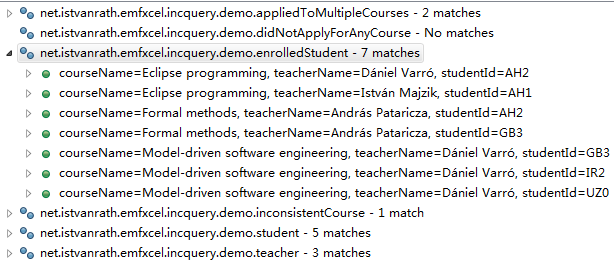

Today, I research on the EMF-inquery example of 'emfxcel'(https://github.com/viatra/EMF-IncQuery-Examples/tree/master/emfxcel), I found it adapt to VIATRA2(My version is 1.5.1), so I modified the suffix of query file and some dependencies. Then I found in the 'Query Results' exporer I can see the the query result, and when I "reinitialize VIATRA viewer " , only seperate student and teacher nodes are displayed in the 'Zest Graph' view, but the edges cann't be shown, Did I omit any part to be modified ?

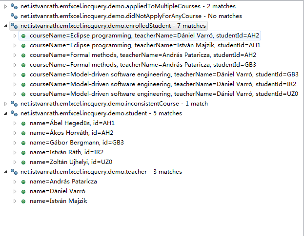

Sorry, it is hard for me to share my current verti with u, But I can describe my problem as detailed as possible, also you can get the example from https://github.com/viatra/EMF-IncQuery-Examples/tree/master/emfxcel.

looking at the screenshots, I see that students are represented by IDs, e.g. 'AH2'; but there is no node named 'AH2' in the Zest graph. This means to me that there is no pattern marked with @Item that enumerates the students for the visualization; and thus the edge cannot be displayed. I see a potential pattern in https://github.com/viatra/EMF-IncQuery-Examples/blob/master/emfxcel/net.istvanrath.emfxcel.incquery/src/net/istvanrath/emfxcel/incquery/demo/SzakiranyDemo.eiq#L26 that could be used for this case.

student Item annotation is below,
@Item(item = id, label = "$name$")
pattern student(name, id) {
find valueInNamedColumn("Students", "First name", rowNum, firstName);
find valueInNamedColumn("Students", "Last name", rowNum, lastName);
find valueInNamedColumn("Students", "Identifier", rowNum, id);
name == eval(firstName + " " + lastName);
we can see it just use the student's name as the label content, that will not change object of students. And above pattern also works well. refer to attachments.
