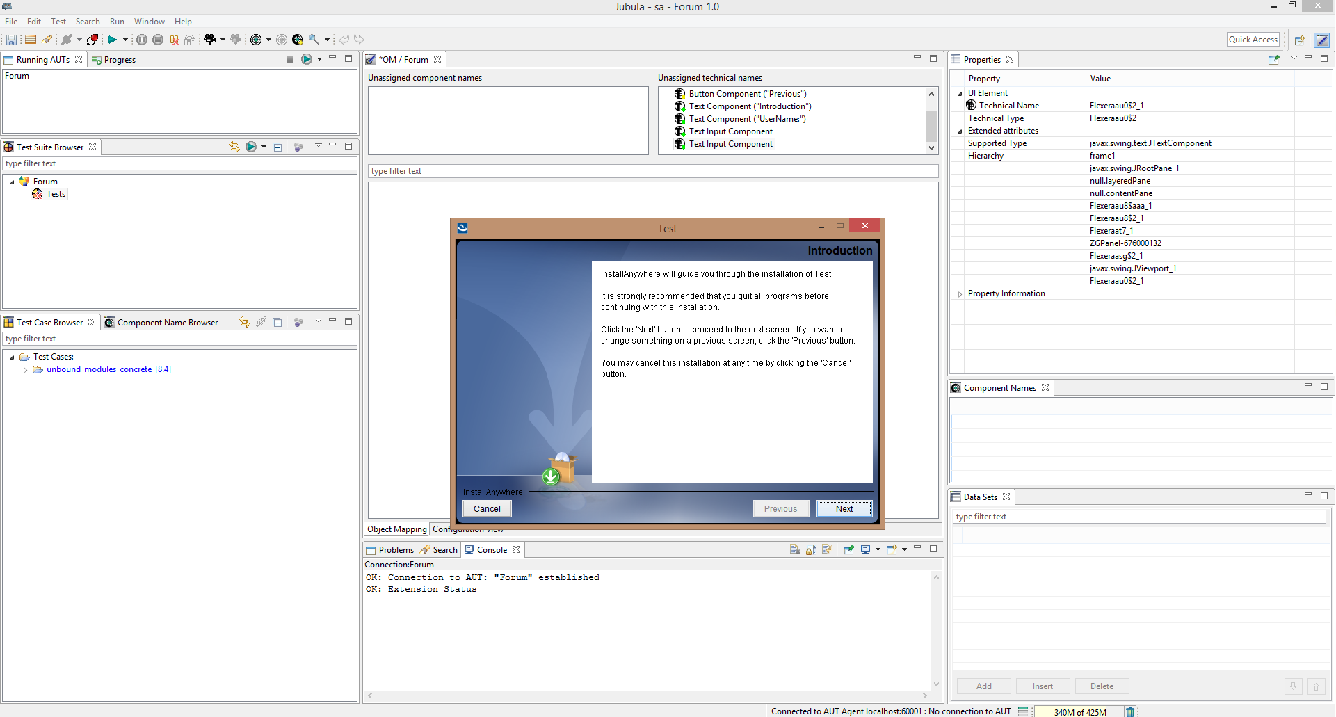

I just tested it with Jubula version 8.4.1.123 as you see on the picture (Forum) I could map the lable, buttons and text components.
It is important that you configure your AUT correctly.

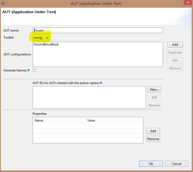

Please ensure that you selected the correct toolkit in the AUT configuration (see picture Forum2)
Kind Regards
Elena
