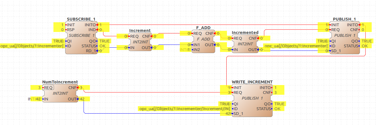

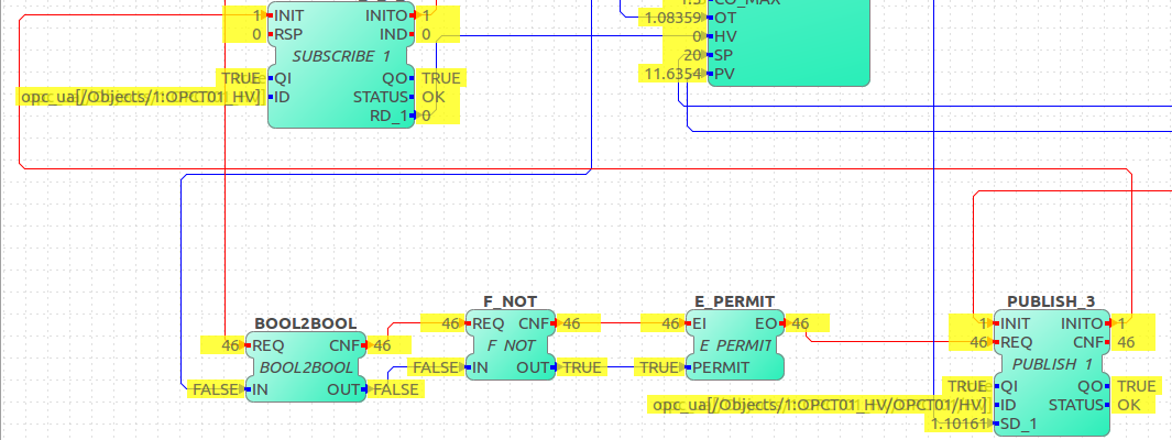

To be clearer see this image bellow:
In the example was created a variable in a server with function block SUBSCRIBE_1 (opc_ua[/Objects/1:OPCT01_HV]) to modify this variable inside the server I am using the PUBLISH_3 (opc_ua[opc.tcp://127.0.0.1:4840#/Objects/1:OPCT01_HV/OPCT01/HV]). For some reason when I do this the forte process (./forte) consumes a lot of cpu resource. In other words instantly the processor activity goes to 90-100%.

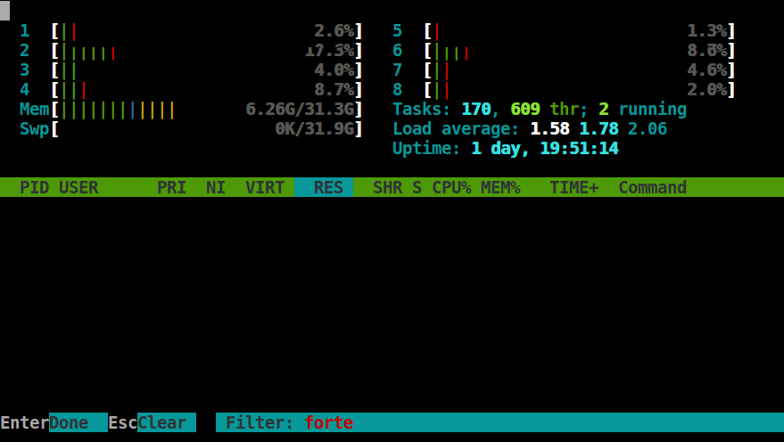

Re: Write and Read OPC_UA Variables in the same server [message #1783574 is a reply to message #1783555] Wed, 14 March 2018 05:34 Go to previous messageGo to next message

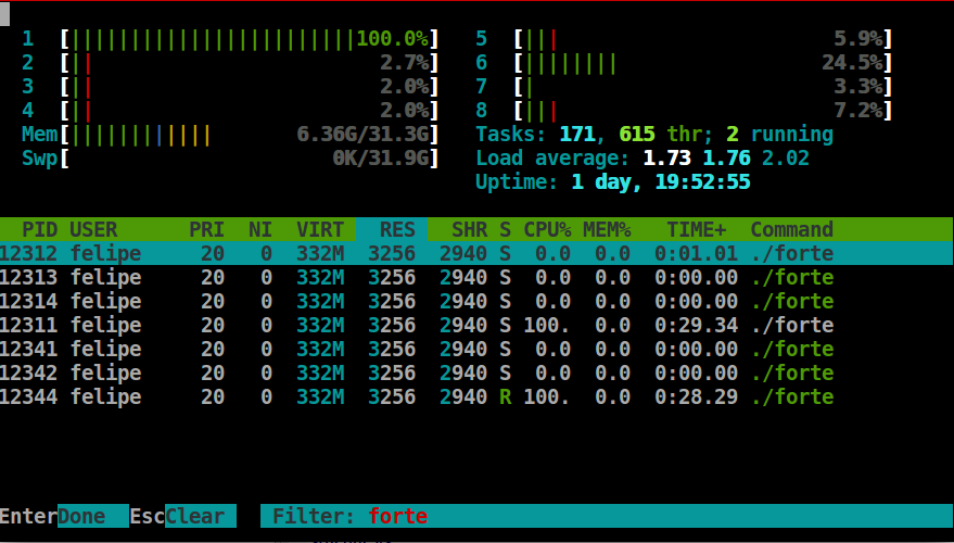

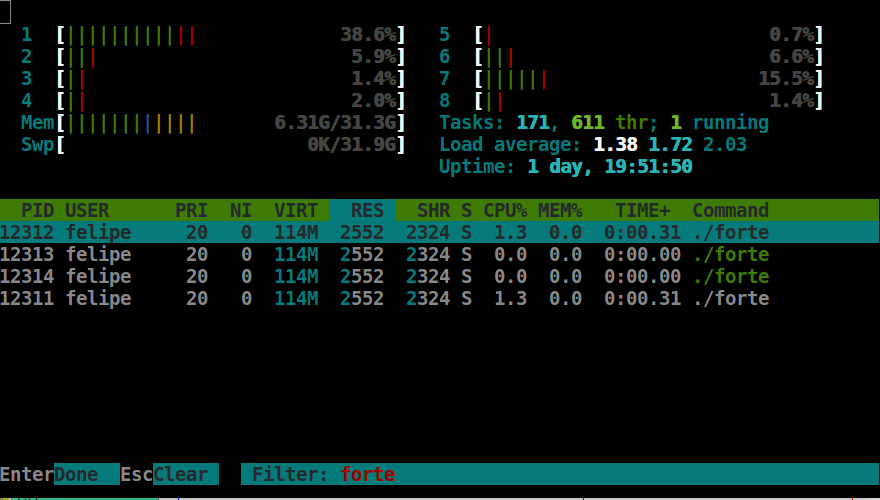

The images bellow show how the processing increases with forte and with forte after deploy.
I make a filter to show just process with name forte.

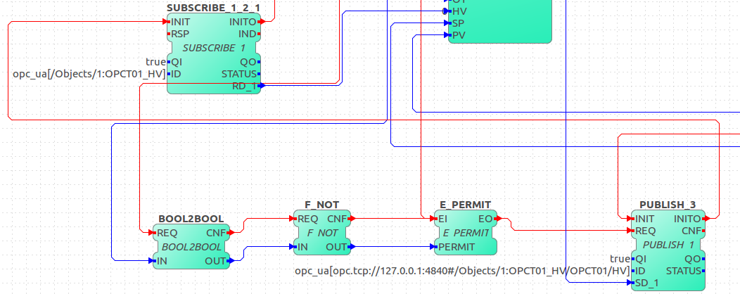

Re: Write and Read OPC_UA Variables in the same server [message #1783726 is a reply to message #1783574] Fri, 16 March 2018 06:23 Go to previous messageGo to next message
Forte handles subscriptions and clients in two different ways:
1. If you are accessing variables on the same local server, it is done by directly accessing the server nodes, without TCP
2. For remote variables an additional thread is used and a async read is performed.
To tell forte if you want to access the local server's nodes or a remote server you need to use the correct syntax for the ID:
Remote:
This tells forte to connect to the server on localhost with port 4840. Since (for now) forte is not so intelligent to detect that it is the local server it is creating a new thread.
Therefore you need to use the following syntax:
Local:
opc_ua[/Objects/1:OPCT01_HV/OPCT01/HV]
i.e. leave the ip and port away.
Does that help?

regarding the 100% cpu usage, may I ask which forte commit are you using for compiling it? Please update the develop branch and see if the problem remain. There might have been a problem that was fixed in august 2017

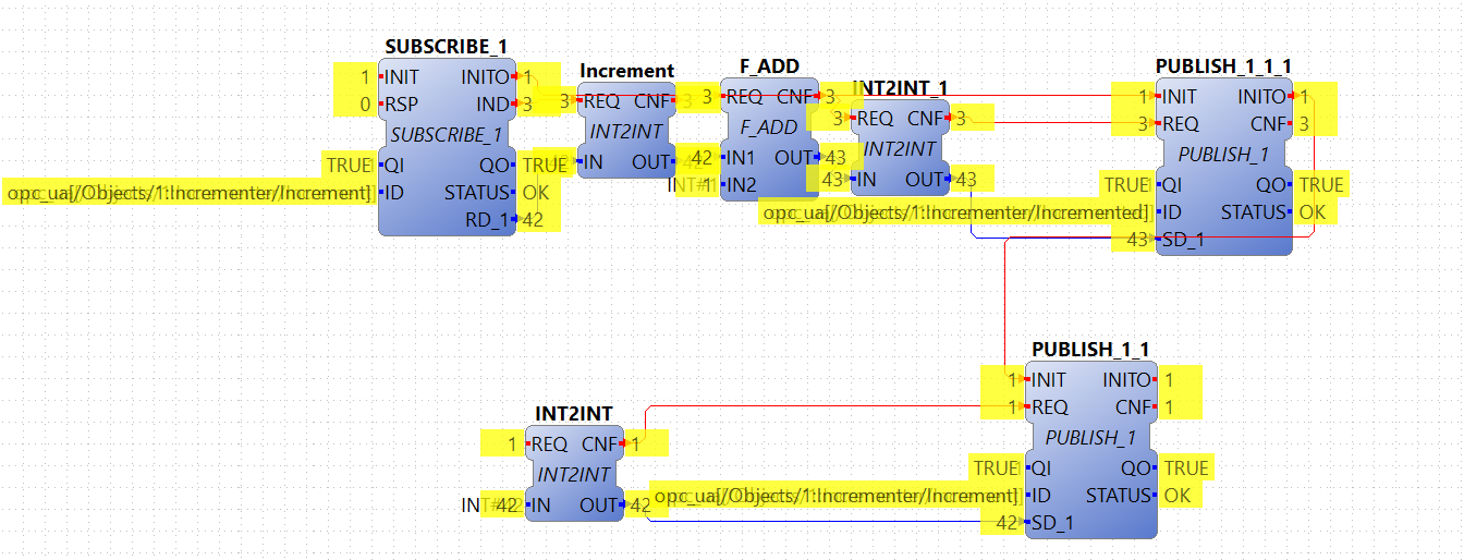

Re: Write and Read OPC_UA Variables in the same server [message #1784012 is a reply to message #1783726] Wed, 21 March 2018 10:28 Go to previous messageGo to next message
Hi Stefan,
well I have tried this but the Publish block can't write on variable created by the Subscribe. The writing just works if I use the PORT and IP.
You can see in the image that the indicator of SIFB SUBSCRIBE never was triggered although the PUBLISH was triggered several times.
Thanks in advance.

Re: Write and Read OPC_UA Variables in the same server [message #1784015 is a reply to message #1784013] Wed, 21 March 2018 10:48 Go to previous messageGo to next message
Hi Felipe,
regarding the 100% CPU the problem shouldn't be there anymore. Your version should be Ok regarding that. Regarding the PUBLISH trying to write to the subscribe, the fix is right in revision so it would be in the next release, and in the repository in the following days

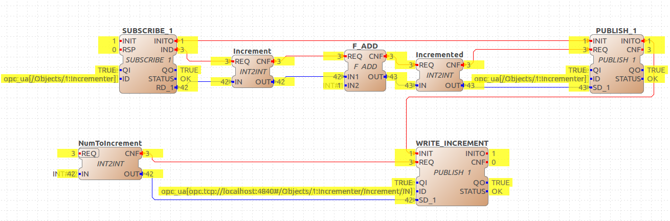

When I try to write in a variable created by SUBSCRIBE block with using a PUBLISH block with the following ID, the variable receive the new value and the SUBSCRIBE block increment the IND event.
But when I try write in the SUBSCRIBE block using the following ID bellow, nothing happens:
This can viewed in the attached pictures.

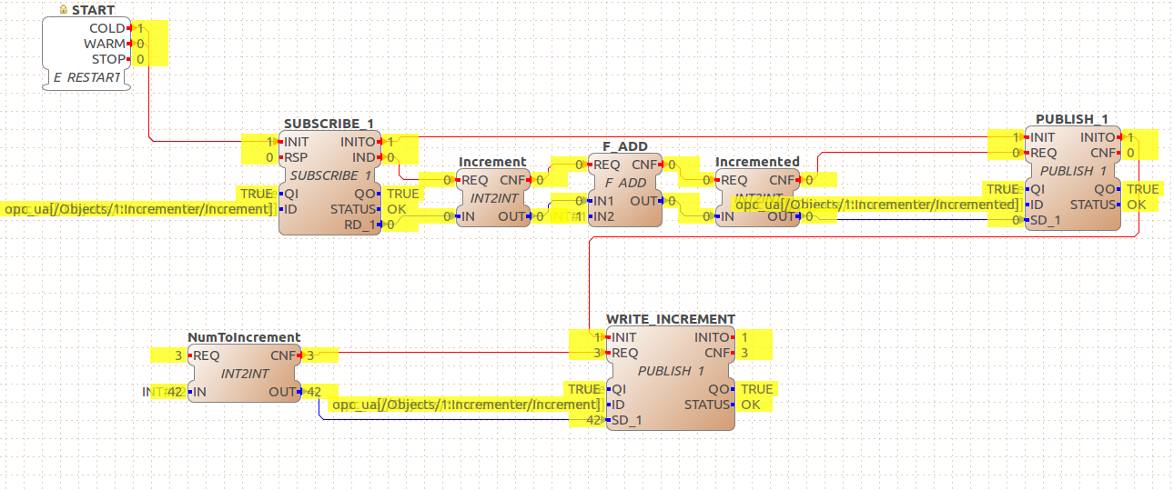

Re: Write and Read OPC_UA Variables in the same server [message #1784203 is a reply to message #1784044] Fri, 23 March 2018 09:46 Go to previous messageGo to next message
if I understoor correctly from your pictures, you're writing a value to the WRITE_INCREMENT (bottom part) and then in one case this change is detected by the SUBSCRIBE_1 with the same opcua variable name, but only when you use localhost:....
is this right?
If so, I'm wondering is it right that WRITE_INCREMENT uses /Objects/1:incrementer/increment/IN, but SUSBCRIBE_1 uses /Objects/1:incrementer. Is this right? are the names different?
Re: Write and Read OPC_UA Variables in the same server [message #1784213 is a reply to message #1784203] Fri, 23 March 2018 10:31 Go to previous messageGo to next message
Oh I see what you're doing now. With the WRITE_INCREMENT you are accesing the absolut path of the variable from SUBSCRIBE_1. I'm not sure about this, but when you use a publish in your local server, it creates or tries to get the variables from the localserver using the ID plus the name and data input/output of the connected FB, like SUBSCRIBE_1 (which uses increment/IN). But if you specify an endpoint (like you did in localhost:4840) it doesn't try to create the variables but only to get them, in your case, it works, since it retrieves the varaible from the server at localhost:4840 (the forte server).
Now, if you don't use localhost:4840, as said it will try to get or create the variable. In your case it looks for Objects/incrementer/IN/NumToIncrement/OUT (since it uses the connected FB). I think the problems lies here because Objects/incrementer/IN is already a variable and it will try to create another variable in it.
I'd say to use the localhost:4840 trick for now, but also suggest to specify in the ID of the opc_ua somehow to specify that the parameter is a absolut path and don't use the connected FB (maybe just for the type but not for the name). This will need some opinion from Stepahn

Re: Write and Read OPC_UA Variables in the same server [message #1784690 is a reply to message #1784044] Mon, 02 April 2018 10:34 Go to previous messageGo to next message
Hi. The reason why you cannot read and write variables on the same server is that Publish/Subscribe blocks while creating variables on the server use the previous/next convert blocks to create a node path. Thus, in your example you read a variable with your Subscribe block from /Objects/Incremeter (your Subscribe block ID) /Increment/IN (your INT2INT block), whereas you write a variable with your WRITE_INCREMENT Publish block to /Objects/Incrementer/Increment/IN (your WRITE_INCREMENT block ID) /INT2INT/OUT (coming from INT2INT block). So you're writing and reading to/from different places. And there's no way to make it work with current forte.
I am not sure if it is a bug or a feature, but it seems it'd be more natural to write the whole node path in the Publish/Subscribe ID parameter for Server FB's, as we do it for our Client FB's, where you specify the whole path in ID parameter.
I did some tests and was able to achieve the setup what you were trying to (see screenshot).
