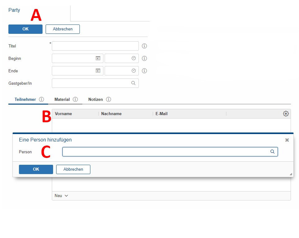

<< see image >>
Use case:
I would like to record the persons from a party (person table is in database available // Mapping table between persons and party is in the database available)
Description of the previous implementation:
I have a party form (A). In this form there are different elements (title, begin, etc.). Likewise a ParticipantsTableField (B) - with the columns "Firstname", "Lastname", "Mail", etc.
If I want to add a new person to the ParticipantsTableField (NewPersonMenu), an AddPersonForm (C) will be opened with a smartfield "PersonLookupCall". This field (PersonLookupCall) is also a master field for other invisible fields - just these additional fields like "Firstname", "Lastname", "Mail", etc.
The action of the NewPersonMenu is checked for an "if - isFormStored ()". If this is true, I create a new line in ParticipantsTableField (createRow) and set this to "Inserted" (setStatusInserted ()).

Your solution looks quite good and resembles the "Event-Form" of the Demo application, so you can consider it close to state of the art :)
Two notes:
You can add a new row more compact: table.addRow(). Since the default implementation will set the row state to inserted, you can remove the last line in your snippet.
Since you already have a smartfield with a lookup call for the person in your "chooser form", you could use the "editable column" feature. Instead of opening a form to choose the person, the user could add rows to the table and edit it inline. As long as it is a AbstractSmartColumn with the lookup call set, it will create the proposal list you're used from smartfields. Check out "getConfiguredEditable" and "getConfiguredMandatory" on the columns. (For reference, check out the widgets demo app).
