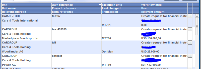

in our application we use a (readonly) grid whose cells are divided into up to 3 "sub rows". (see attached image). Each sub row may display it's own tooltip.
The appearance of the rows is realized using HTML MARKUP.
We therefore wanted to use the title tag on the <span> (in each row) in order to make the browser display it's own tooltip.
Problem: "title" isn't a supported attribute for the <span> tag (although it should be a global attribute and therefore can applied to any HTML tag).
For now we can work around that by disabling the markup validation, but I wanted to ask, if you could add "title" to the MarkupValidator's allowed attribute list in an upcoming patch.

Adding "title" attribute to MarkupValidator is not a problem. Please open an enhancement request to track the progress.
