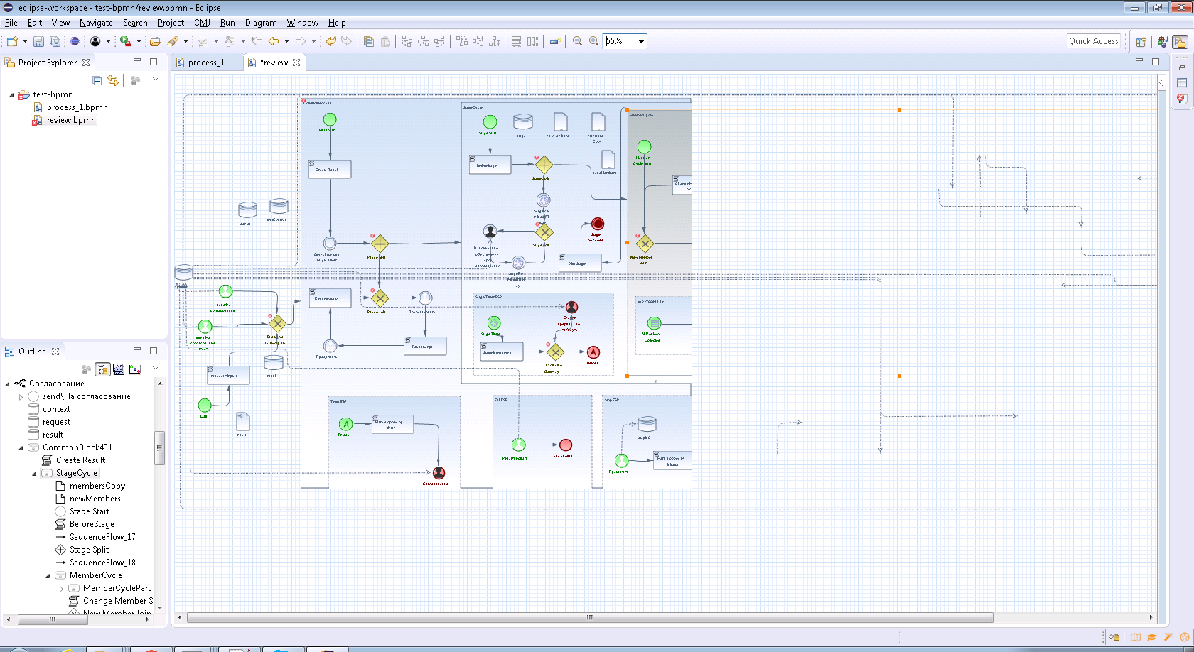

Hello, we have diagram whose not displayed fully in BPMN Modeler: only left part is visible, but right part has disappeared
Version: Oxygen 4.7.0
BPMN Modeler 1.4.1
see review_clear.bpmn
see attachemnt index.php/fa/31353/0/
In Kepler BPMN Modeler we just resize some element on diagram to solve this problem, but in Oxygen this approache does not work
has anyone encountered a similar problem?

Guys, problem solved.
The cause of problem: child sub-process overlap boundaries of parent sub-process in the schema (not see at once),
after reorganizing some sub-processes all elements will be displayed
Thanks all for reading

there are continue of this story, we can break schema by a trick.
we draw three internal sub-processes and two task on inner sub-process, after that we move inner sub-process across of boundaries parent sub-process and drop catch event between task, and here this event may get incorrect container
see attachment-demo
think, its a bug

I see the same original problem, interestingly my large subprocesses are resized to width =1000 when loaded so I had thought this was related to this un-merged pull request. https://github.com/eclipse/bpmn2-modeler/pull/10
Re: problem with displaying large diagram [message #1785231 is a reply to message #1785227] Wed, 11 April 2018 05:10 Go to previous messageGo to next message
I have created the simplest process diagram I can (attached) which is a subprocess with 2 tasks and a start and end event. The subprocess has a width of over 1000, when close it and open it again it IT gets resized to 1000 which is very frustrating and ugly (see attached screenshot). Looks like a bug to me, or am I missing something ? I am using BPMN2 Modeler version 1.4.2 with Eclipse Oxygen
[Updated on: Wed, 11 April 2018 05:13] by Moderator
Re: problem with displaying large diagram [message #1785385 is a reply to message #1785231] Fri, 13 April 2018 06:45 Go to previous messageGo to next message
added bugreport for this https://bugs.eclipse.org/bugs/show_bug.cgi?id=533540
