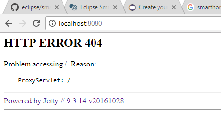

Hi. I have a problem about your guide. I did everything which written in the following tutorial
https://www.eclipse.org/smarthome/documentation/development/ide.html
program is runnig but in the end forwarding to this page http://localhost:8080/paperui/index.html
give as a response :
HTTP ERROR 404
Problem accessing /paperui/index.html. Reason:
ProxyServlet: /paperui/index.html
Powered by Jetty:// 9.3.14.v20161028
I can't find the solution of the problem, please give me the right direction to find out the problem.
thanks in advance

I am having the same issue - looks like I am having an issue with the 'Launch PaperUI Setup' step:
Performing Launch PaperUI Setup
Execute Debug Command
Synchronizing Resources...
Updating Git status for repository smarthome
Updating Git status for repository smarthome:   0% (  57/5740)
[INFO] Scanning for projects...
[ERROR] Internal error: java.lang.RuntimeException: Could not resolve target platform specification artifact org.eclipse.smarthome:targetplatform:target:smarthome:0.9.0-SNAPSHOT -> [Help 1]

This is indeed a known problem, see also https://www.eclipse.org/forums/index.php?t=msg&th=1089731&goto=1775455&#msg_1775455.
Please run a "mvn clean install" from the command line and the Paper UI should be all fine afterwards!
