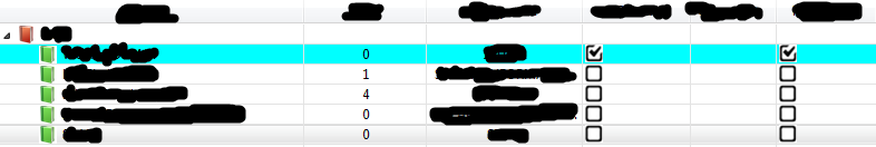

I have a tree/table.
I need to interact with it. I know how to get the value in the tree
System.out.println(ff.bot().tree().getTreeItem("J").getNode("WORD").cell(1));
How can I modify this value?
Example a list, a checkbox, text...
