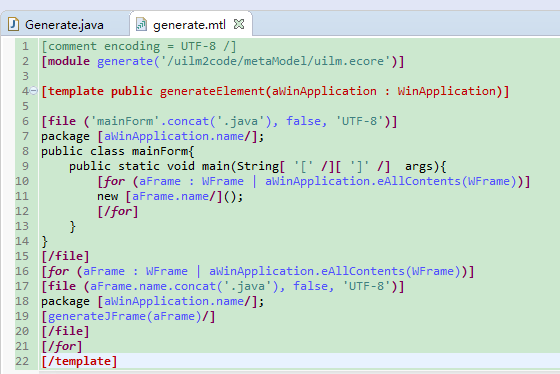

The wrong info are follows:
The generation failed to generate any file because there are no model elements that matches at least the type of the first parameter of one of your main templates.
The problem may be caused by a problem with the registration of your metamodel, please see the method named "registerPackages" in the Java launcher of your generator. It could also come from a missing [comment @main/]
in the template used as the entry point of the generation.
but i really have winapplication this element:

Re: Acceleo run error [message #1767939 is a reply to message #1767937] Wed, 12 July 2017 09:33 Go to previous messageGo to next message
wang shiyu is currently offline wang shiyuFriend
Messages: 18
Registered: June 2017
Junior Member
what should i do to fix this problem?
Re: Acceleo run error [message #1768056 is a reply to message #1767939] Thu, 13 July 2017 10:26 Go to previous message
Laurent Goubet is currently offline Laurent GoubetFriend
Messages: 1898
Registered: July 2009
Senior Member
The problem here is the way you're referencing your model.
[module('/uilm2code/metamodel/uilm.ecore')/]
should be
[module('http://www.example.org/uilm')/]
