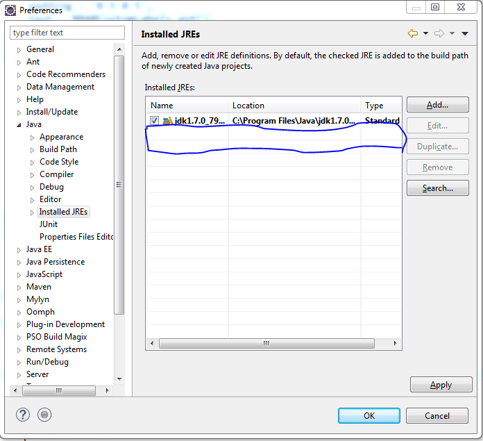

I am actually trying to directly add a new entry in the Installed JRE option with the help of code not the wizard, i need to know how do i do that, can i get any support in case of code, if yes please provide me some assistance?
Please see the picture for description. I need to add a new entry in the box outlined with blue color.

Re: adding a new VM to installed JRE workbench [message #1768079 is a reply to message #1768066] Thu, 13 July 2017 09:06 Go to previous messageGo to next message
I've attached an Oomph task implementation that's designed to create a new JRE entry. You should get the general ideas for how to do this programmatically from this.
