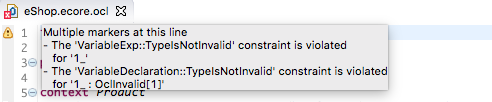

On line 1, import statement, I have bellow warning:
index.php/fa/29650/0/

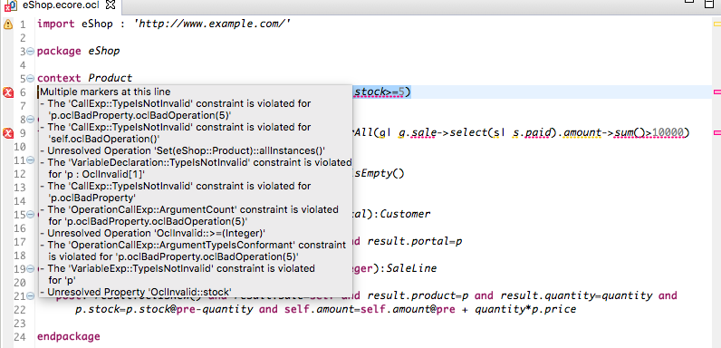

For line 6, inv minStock: Product::allInstances()->forAll(p|p.stock>=5), I have the bellow error:
index.php/fa/29651/0/

I don't know why you do
import eShop : 'http://www.example.com/'
For which the error message is:
Multiple markers at this line
- Unresolved Namespace 'http://www.example.com/'
- The required feature 'pivot::Import::importedNamespace' of 'eShop : «null»' must be set
If I do
import eShop : 'eShop.ecore'
it works fine.
Ed Willink
