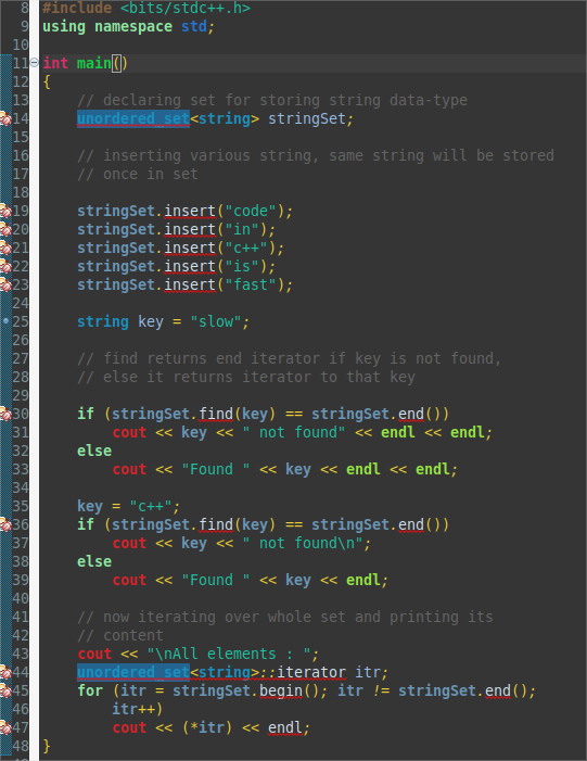

Hi All,
I downloaded the example code for std::unordered_set. It compiles ok but still the indexing doesn't appear to work after following all your advices.
Attached is a screenshot of the code in Eclipse Version: 2023-09 (4.29.0) Build id: 20230907-1323
Is there a definitive solution to this issue?
Thanks a lot
