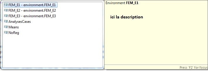

I created a new grammar with Xtext 2.11 (it works) and I want to personnalize the autocompletion.
For example, I have two objects in my grammar
      Environment:
	'ENV_TYPE' name=ID
	'Description' (Description=STRING)
      Test
	'TEST_TYPE' name=ID
        'Environment' Environment=[Environment]
I would like in eclipse during autocompletion (on Environment attribut in TEST object) retrieving Environment'ID and in the yellow part the environment's description (cf attachment)
index.php/fa/29434/0/
How do you do that ?

You can have a look at IEObjectDocumentationProvider.
that one is used to calculate the hover tooltip (that is used for proposals as well)

When Eclipse loads, I pass by bindIEObjectDocumentationProvider() but my sentence "Je mets ce que je veux" does not appear.
What have I forgotten

@Inject
def public Class<? extends SvcIEObjectDocumentationProvider> bindIEObjectDocumentationProvider() {
return SvcIEObjectDocumentationProvider;
makes no sence. this is a binding not a injection
and the type is wrong
class MyDslUiModule extends AbstractMyDslUiModule {
    def public Class<? extends IEObjectDocumentationProvider> bindIEObjectDocumentationProvider() {

Thank you. You save me, it works.
