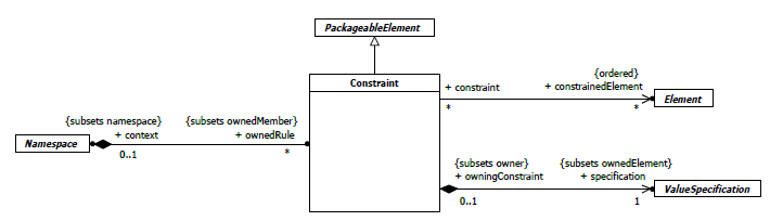

I would like to clarify the definition of what is the context of an OCL constraint when used with UML.
Figure 7.6.2 in [UML 2.5] defines the syntactic element Constraint as follows:
index.php/fa/29302/0/
  1. constrainedElement: the ordered set of elements referenced by this constraint.
  2. specification: a condition that must be true when evaluated.
  3. context: specifies the namespace that owns the constraint.
The association A_ownedRule_context (see section 7.9.22 in [UML 2.5]) ends both subset ends of the association A_ownedMember_namespace (see section 7.9.19 in [UML 2.5]).
The interest of the association A_ownedRule_context seems to enable the designer to explicitly define "the Namespace for interpreting names used in the specification (for example, in OCL self is used to refer the context element)" see section 7.6.3 in [UML 2.5]. Based on this, in Papyrus self always evaluates on the specified context.

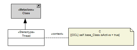

index.php/fa/29303/0/
For instance, in the above figure, C has Thread for context (which means that Thread owns the constraint C) and Thread is referenced in the list of constrained element. In such configuration, the constraint C specified with OCL evaluates to true.
Now if we change the context (e.g., to store our constraints in a Constraints package) then C is owned by that package while still constraining Thread. At this point the validation of the constraint fails due to the update of the context. While the evaluation of self to the context (i.e., the Constraints package) conforms to what UML specifies, it does not look to be the correct behavior to the final user since the constrained element did not change.
The OCL specification (see section 12.1 in [OCL 2.4]) defines the notion of contextual classifier and self instance.
  1. Contextual classifier: defines the namespace in which the expression is evaluated.
  2. Self instance: is the reference to the object that evaluates the expression. It is always an instance of the contextual classifier.
It also provides a clear definition about the way an invariant must be specified for a Classifier (see section 12.6.1 in [OCL 2.4]). The first rule specifies that "The constraint has the stereotype «invariant» (A) and the constraint is attached to only one model element (B) the constraint is attached to a Classifier (C). The contextual classifier is the constrained element and the type of the OCL expression must be Boolean."
Considering these points, it seems clear that the self shall be resolved based on the constrained element. However this somehow contradicts what is in in UML specification (see section 7.6.3 in [UML 2.5]). In addition, this leads to an interrogation: why do we need in UML to define the association A_ownedRule_context (see section 7.9.22 in [UML 2.5])? It looks that only with A_ownedMember_namespace (see section 7.9.19 in [UML 2.5]) we have the capability to provide a namespace for a Constraint that is basically given by its owning element.

Very short answer: What you ask is not defined by the UML or OCL specifications.
