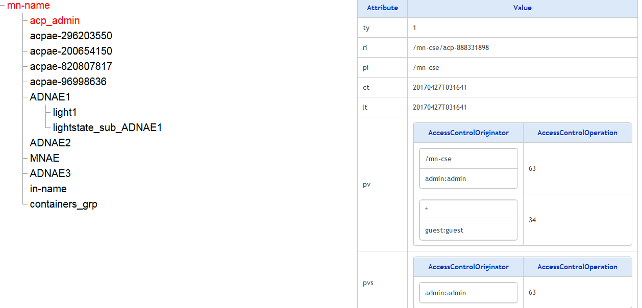

I have below setup and registered the application(SmartHomeApp) under IN-CSE and all other AE's under MN-CSE
10.37.3.xx-->MN-CSE
10.37.2.xx-->In-CSE
I have created a group resource, and mapped couple of containers to it. ACP profile of the MN-CSE is automatically applied to this resource. No separate ACP was created for this.
Please refer the attached screen shot for the resources configured under MN-CSE. When I try to create the container instance for the grp , I get a error as below "Current resource does not have any ACP attached"
POST:http://10.37.3.XX:8282/~/mn-cse/mn-name/containers_grp
{ "m2m:cin": {
"cnf": "text/plain:0",
"con": "GRP"
Questions:
Default ACP should be picked if not specified? How can I include the ACP profile in above request.
Can I create a subscription for this group?

how you connect your mn-cse and in-cse.
What have you done? An application on mn and on in, or?
Thank you

I used the REST client and followed the instructions in below URL to configure the devices. I did with simple REST client(PostMan)
Not able to test the grouping resource, Any pointers on that will be helpful
