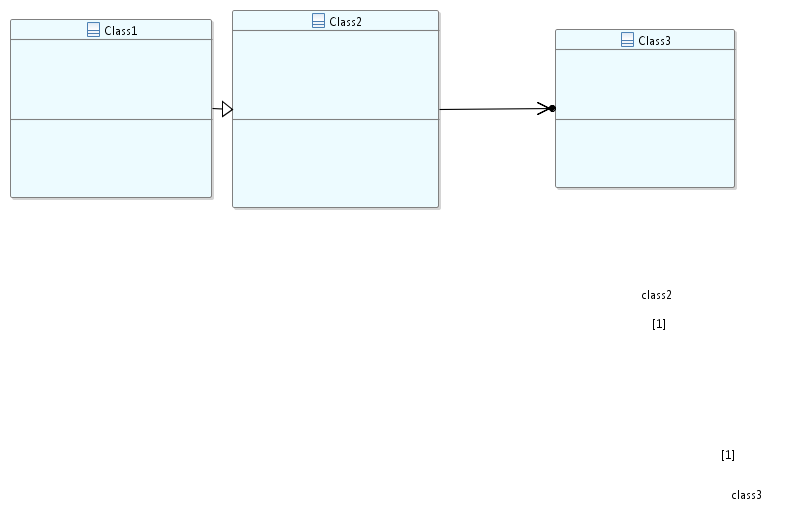

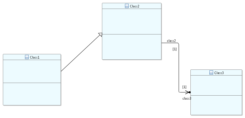

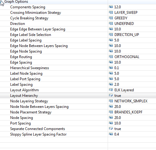

I tried to layout a class diagram but it seems to not consider the edge labels. Am I doing something wrong?
index.php/fa/28635/0/
index.php/fa/28636/0/
index.php/fa/28637/0/
  • Attachment: before.png
    (Size: 9.44KB, Downloaded 474 times)
  • Attachment: after.png
    (Size: 6.38KB, Downloaded 465 times)
  • Attachment: settings.png
    (Size: 21.12KB, Downloaded 610 times)
Re: Problem with edge labels [message #1755421 is a reply to message #1755369] Fri, 03 March 2017 03:38 Go to previous messageGo to next message
Hi Peter,
I believe I need more information. Smile For starters, which drawing framework do you use to draw / edit your diagrams? Have you implemented your own DiagramLayoutConnector?

Re: Problem with edge labels [message #1755797 is a reply to message #1755369] Wed, 08 March 2017 04:22 Go to previous messageGo to next message
There was a bug in the configuration of the processors in the release. It should be fixed on the current master.
https://github.com/eclipse/elk/pull/142
Re: Problem with edge labels [message #1755829 is a reply to message #1755797] Wed, 08 March 2017 08:51 Go to previous message
Oh, that's interesting. I only looked at the current master and couldn't see anything wrong with it, but had forgotten all about the pull request. That will be fixed in 0.2.1 once that is released (we haven't decided on a release date yet).
