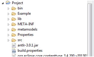

When I do above steps, I have this Project in my work space:
index.php/fa/28594/0/

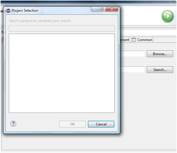

When I run it as Java application and I Browse to select Project name (and main class) there is nothing to select:
index.php/fa/28595/0/

The archive you've imported from doesn't appear to have included files like the .project (describes the natures and builder for this project) and .classpath (describes the Java classpath, e.g., where are the source folder and the out folders) files that would normally be part of an exported existing project. So it's a question of where did this archive come from and why did whomever provided it not include important files like the .project and .classpath files in the root of the project.
