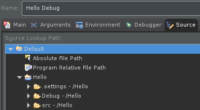

Is there any doumentation on what the different source container types that you can add to the source lookup path in a debug launchc onfiguration actually do.
If not can, someone point me at where amongst the many source repositories and files I can find the code that implements this stuff. A URL would be nice.
On my installation I am offered the following container types.
1. Absolute file path - The does not ask for any additional parameters. So I have no idea what it does.
2. Compilation directory - This brings up a parameter dialog that has some explanation in it, I am guessing that this wants an absolute file system path that will be used as a root to be fed into the gdb path resolver.
3. File system directory. How is this different from number 2.
4. Path mapping. This is the only one I understand.
5. Program relative file path. Like number 1, so no idea.
6. Project - This asks for another project. But no information on how this affects the paths.
7. Project - Path relative to source folders. No explanation of what this means in this context.
8. Workspace - Asks for a workspace. . No explanation of what this means in this context.
9. Workspace folder - Asks for a folder in a workspace. No explanation of what this means in this context.

1. Absolute file path - An absolute path specified within the debug information block
2. Compilation directory - relative to the directory where the compile occurred
3. File system directory - any directory within the file system
4. Path mapping. - You say you understand this one.
5. Program relative file path - path relative to the location of the executable
6. Project - all directories within a given project are searched
7. Project - Path relative to source folders within a project (e.g., proj/src)
8. Workspace - All directories within the workspace
9. Workspace folder - Asks for a folder in a workspace - self explanatory
The source path types are listed here:
http://help.eclipse.org/neon/index.jsp?topic=%2Forg.eclipse.cdt.doc.user%2Freference%2Fcdt_u_dbg_src.htm
What they mean specifically is not documented.

When I changed the source location to Program Relative, Eclipse tried to find the source at /home/dvavra/proj/Hello/Debug/src/Hello.cpp (which is <exec path>/<subdir 'src'>/Hello.cpp) for the first breakpoint. GDB had no trouble listing the code at the breakpoint. I'm not sure but I think /home/dvavra/proj/Hello/Debug/src was simply the last directory tried by Eclipse and not something from the debug info.
Compilation directory asked for the directory location then used that as the base directory path.
When I set a breakpoint, Eclipse sent the relative and absolute paths. In this case the debug source paths (in Eclipse) started at the project directory.
