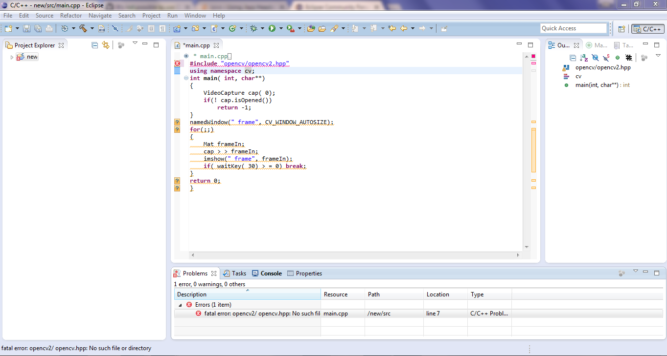

trying to use opencv on eclipse. I have included all the files i've been told to include according to a book im using but i still get this error with the sample code.
can i get some help on how to solve this thanks

You need to tell both the compiler and the indexer where the opencv header files are located.
The include directories can be found by executing (in a command terminal):
In my system they are in: /usr/include/opencv
$ pkg-config --cflags opencv
-I/usr/include/opencv
You tell the compiler where they are (assuming Exlipse is generating the Makefile) at
Project --> Properties --> C/C++ Build --> Settings under Includes for each compiler used.
Drop the -I and put the rest in the top pane (the paths pane),
The indexer needs to be to told at Project --> Properties --> C/C++ General --> Preprocessor Include Paths, Macros etc.
If the include path for opencv doesn't apper under Managed Build Settings then
1) ensue the Managed Build provider is enabled in the Providers tab; the path should be found at the next build
2) You can also set the directory as a user entry on the Entries tab
You also need to tell the linker where and the libraries are and which libraries to use:
Project --> Properties --> C/C++ Build --> Settings --> Linker --> Libraries
Run pkg-config --libs opencv in a terminal
Add the output preceded by -L (without the -L) to the bottom pane
Add the output preceded by -l (without the -l) to the top pane
They have to be added one at a time -- a bit tedious.
Another option is to add `pkg-config --libs opencv` to the linker command:
${COMMAND} ${FLAGS} ${OUTPUT_FLAG} ${OUTPUT_PREFIX}${OUTPUT} ${INPUTS} `pkg-config opencv --libs`
Note the back tics around the pkg-config command. It will likely only work under Linux.
