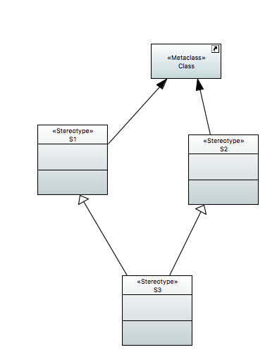

Hi there,
We currently have a problem related to modeling multiple inheritance using Papyrus creating an UML profile.
As shown in screenshot provided, we created three Stereotypes S1, S2 and S3 (base class UML::Class). When we want to create a UML model and try to apply S2 to a Class, nothing happens.
Please advise, minimal example provided.
Cheers,
Will

In fact, you have fin a a bug: may be due to ecore
when you create a stereotype a property named base_<metaclass> is created in the stereotype.
In your case S3 inherits form S1 and S2. So by inheritance it references 2 properties named base_class.
In order to run you profile we must delegate to EMF ecore a profile definition ( a generation of a ecore model) But ecore does not like that S3 reference 2 references with the same name. So it named the Eref as S2_base_class. and this is the problem.
Rename this ereference and it runs
Could you add this problem in the papyrus bugzilla, please.
Could you add this problem with ecore it in the bugzilla please.

Re: Multiple Inheritance in UML Profile [message #1754079 is a reply to message #1753990] Tue, 14 February 2017 07:15 Go to previous message
Thanks! I have created a bug report.
P.S. Do we get chocolate for discovering bugs?
