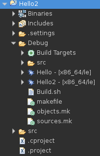

I think you are confusing launch configurations with projects. The project is used to create and contain the executable. The launch configuration is used to run the program or debug it. The launch configuration is not associated with any projects. You can theoretically run or debug any executable in your system. Both run and debug use the same configuration file.
After copying a project you need to rebuild it. The following is showing a copy of project Hello to Hello2. It has been rebuilt. The executable's name is Hello2
index.php/fa/28014/0/
You then create one or more launch configurations with different arguments. The name of the configuration must be unique.
