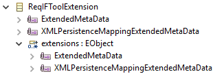

I'm currently becoming desperate while trying to load an extended ecore model. In particular, I want to handle a ReqIF compliant XMI file which contains so called tool extension. The belonging excerpt of the ReqIF Ecore file is
index.php/fa/27986/0/

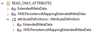

If I create an EClass for the element <doors:READONLY-ATTRIBUTES> according to the example above, I get the following result:
index.php/fa/27988/0/
This is the own defined EClass for READONLY-ATTRIBUTES which is configured by ExtendedMetaData EAnnotations for XML persistence.
Reading the example above does not work. Writing a file using this configuration results in the following XML content:

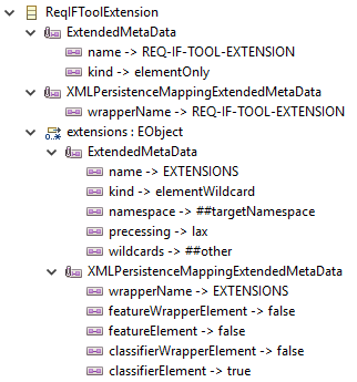

I see, that the ReqIFToolExtension.extensions is defined as lax element wildcard by the ExtendedMetaData.
index.php/fa/27995/0/
But I don't know how to use it for my purpose because I want to read the content of READONLY-ATTRIBUTES not as AnyType but semantically as references to a AttributeDefinition from the ReqIF Ecore meta model.
