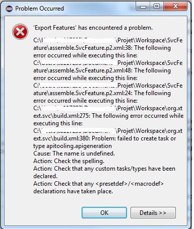

I created my DSL and tested it with "Eclipse Application". It works correctly.
Now, I would like to export it in a plug-in. I do not know how do that:
- can you explain me the different steps (It 's my first plug-in)
In the attachment, you find my error message
Thank you
Pascal
  • Attachment: Problem.jpg
    (Size: 89.70KB, Downloaded 164 times)

Hi, Can you share what you actually do on export? Which options did you choose in the create xtext project wizard?

Pascal,
do you use a build system?
You can select it in the "New Xtext project" wizard.
I would suggest to select the following in the wizard:
- create feature
- create updatesite (<- this will allow you to distribute your language)
- build system = "maven"
- source layout ="plain"
After running the maven build you will get an update site in:
org.xtext.svc.repository/target/repository
Re: How to create my plug-in ? [message #1747982 is a reply to message #1747971] Thu, 17 November 2016 07:40 Go to previous messageGo to next message
Thanks for your answer.
Dennis : I do not use build system (Maven, Gradle)
Dennis - Christian : My project had the default option (Eclipse plugin, Generic IDE Support, Testing Support).
I did a new project and added the option Create Feature but the I have the same problem. My project is the default project.
Re: How to create my plug-in ? [message #1747984 is a reply to message #1747982] Thu, 17 November 2016 07:51 Go to previous messageGo to next message
ill recommend you to use maven as build system.
from the error message you gave i have no idea whats wrong with your installation
Re: How to create my plug-in ? [message #1747989 is a reply to message #1747982] Thu, 17 November 2016 08:43 Go to previous messageGo to next message
Pascal,
it's really not easy to write a PDE feature export "How to". The best would be to re-run the new Xtext wizard with a build system selected. After that you can paste you grammar + additional changes in the new created projects
Best regards.
Re: How to create my plug-in ? [message #1748049 is a reply to message #1747989] Fri, 18 November 2016 03:24 Go to previous messageGo to next message
Thanks for your answer. I tried it yesterday but did not work.
I suppose I have to do that : https://www.eclipse.org/Xtext/documentation/350_continuous_integration.html
before to use the Maven build.
Re: How to create my plug-in ? [message #1748078 is a reply to message #1748049] Fri, 18 November 2016 05:58 Go to previous message
no you can select it in the new project wizard
select maven as build system and enable "create feature" und "create updatesite"
