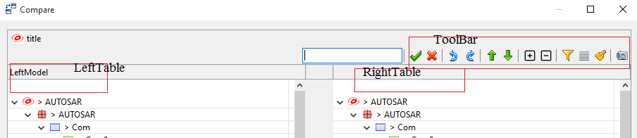

I have one compare dialog in which some toolbar button and one content merge viewer (divided in two part Left and Right) and two button (Commit and Cancel )is present .
Now the problem is i'm able to access the toolbar button and other two button but two table view Left and Right are unable to access in SWTBot.
please find the following attached picture.
please suggest any solution.

Hi Ram,
How are you trying to access the tables? Looking at the screenshots, they are apparently trees, not tables, so I would expect to be able to access them using bot.tree(0) and bot.tree(1) ?
But that is assuming the application under test is using a Tree widget, could it be using some kind of custom widget? Can you verify in the source code?
Patrick
