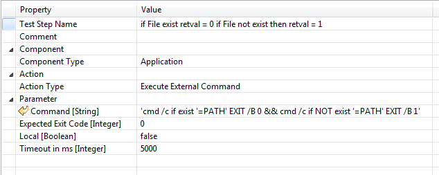

hi there,
i tried to get rid of my execute external command steps (the old ones) and replace them withe the new ones but i didn't get how i have to set the parameters in the new step to get it running....
maybe you can give an example how a step and it parameters looked in the old version and how in will look like in the new version of the step.
here is a screenshot of the old version step in my case:
index.php/fa/27132/0/
how would this case look in the new version?
best regards
dominik

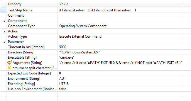

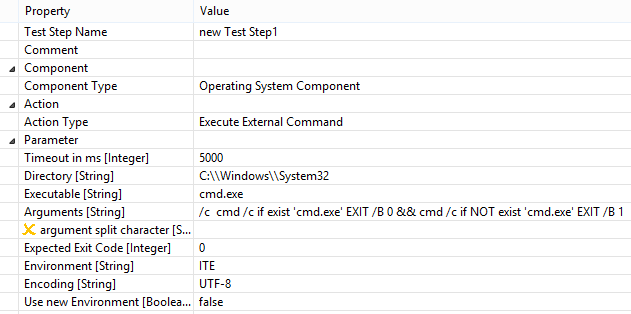

i tried to do that but i couldn't get it run. Maybe you can help me...
my old step (works):
index.php/fa/27165/0/
my new step (not working):
index.php/fa/27166/0/
result:
index.php/fa/27167/0/
i couldn't figure out what the problem is...
best regards
Dominik

there might currently be a bug when using directories with back slashes (e.g. in Windows) as an argument for the Directory parameter. Could you please try using the following as directory: "C:\\Windows\\System32\\" and if that is not working please try it without \\ at the end.
Kevin
EDIT: This actually is not a bug but all parameters with back slashes require escaped back slashes "\\". This information is missing in the documentation of Execute External Command and will be added.

i tried your suggestions Kevin but no version i tried was working.... you can have a look at it here:
index.php/fa/27208/0/
Achim i can assure you that it is working on windows you can see a screenshot here:
index.php/fa/27209/0/
any other idea what i can try?
best regards
Dominik
ps i tried it also without the double quotes (") and the \\ instead of \
[Updated on: Mon, 26 September 2016 02:08] by Moderator

thanks for your help, Kevin. i tried your configuration and it's working now. the problem was the environment....
if i try to run the same configuration in environment of AUT its not working. with ITE its working...
