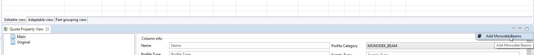

I have a specific Property View's menu in my RCP.
I don't know how to select one element in this view's menu.

can you post an image of the view with the component you want to address highlighted?

Here it is.

to address this component, you should use the unbound module "ub_grc_selectContextMenubyTextpath".
For the parameter "mouse button", use '1' - this means that the context menu on the component will be opened with a left click ('3' would be a right click, but this isn't needed for such components).
