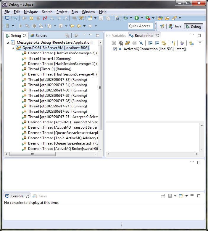

I am trying to debug the Apache ActiveMQ message broker using remote debugging in Eclipse.
I have activated the debugger on the message broker side by commenting the specified line in the ActiveMQ startup script.
I have downloaded the source code for the version of ActiveMQ I am using and added it to an Eclipse project.
I have configured a remote debugging session in Eclipse.
I have set a breakpoint in the ActiveMQ Connection source code at the start() function, which I am certain is executed when I run my JMS client.
I start the message broker, start the remote debugger session in Eclipse and start my JMS client app.
I can see that my app makes a connection but the debug session nevers shows my breakpoint or the source code. I have attached a screen shot of what the debugger looks like at the point where I would expect to see the source code stopped at my break point.
Can you tell me what is wrong?
Thank you.

In fact, for the source code I downloaded from the Apache web site and the version of Apache ActiveMQ I am attempting to debug, I did have this working somewhat in the past. I created a new project and re-imported the source code to try to correct some of the earlier problems I was having and that made things worse. As you can see from the screen image I uploaded, the tab in the IDE that should contain the source code is totally blank. In fact it does not even contain the usual message I have seen in the past when Eclipse can't find the source code.

The screenshot doesn't prove much, because we don't know why it should show any source code in the current state (i.e., no breakpoint has fired).
