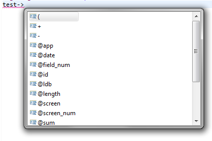

Content assist showing unwanted contents.

Re: Xtext showing unwanted contents [message #1740060 is a reply to message #1740058] Mon, 08 August 2016 11:05 Go to previous messageGo to next message
COMPLETION_AUTO_ACTIVATION_CHARS and the content assist entries hav nothing todo with each other.
it seems like your grammar is in a way that error recovery doesnt know what to do.
this is why you get this very generic proposals
Re: Xtext showing unwanted contents [message #1740064 is a reply to message #1740058] Mon, 08 August 2016 13:02 Go to previous messageGo to next message
Which kind of proposals would you expect?
Which proposals are wrong?
Did you customize your proposal provider?
Do you have backtracking enabled?

What kind of customization I need to do?
Re: Xtext showing unwanted contents [message #1740122 is a reply to message #1740120] Tue, 09 August 2016 08:44 Go to previous messageGo to next message
When I click on @app()->, @widget()-> etc it should only '@app()', '@widget' related stuff but it is calling 'sm_' and 'dm_' stuff also.
Re: Xtext showing unwanted contents [message #1740694 is a reply to message #1740122] Wed, 17 August 2016 07:06 Go to previous messageGo to next message
I have added return in all overridden proposal methods still content assist showing the junk values.
Re: Xtext showing unwanted contents [message #1740695 is a reply to message #1740694] Wed, 17 August 2016 07:12 Go to previous messageGo to next message
Sry. From my point of view we have discussed a lot about your grammar problems. Unless you don't solve then systematically ...
If you override all methods e.g. Complete keyword you won't get any of the proposals in the screenshot
Re: Xtext showing unwanted contents [message #1740699 is a reply to message #1740695] Wed, 17 August 2016 07:26 Go to previous messageGo to next message
I overrode every method still it is coming.
Re: Xtext showing unwanted contents [message #1740702 is a reply to message #1740699] Wed, 17 August 2016 08:08 Go to previous messageGo to next message
please create a new minimal + complete grammar what reproduces the problem and share it with your proposal provider
Re: Xtext showing unwanted contents [message #1740703 is a reply to message #1740702] Wed, 17 August 2016 08:15 Go to previous message
I confirm that a backtracking grammar may cause the content assist provider to give unexpected proposals.
Refactoring the grammar for removing backtracking had solved my issue.
