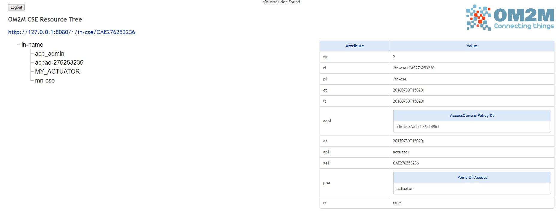

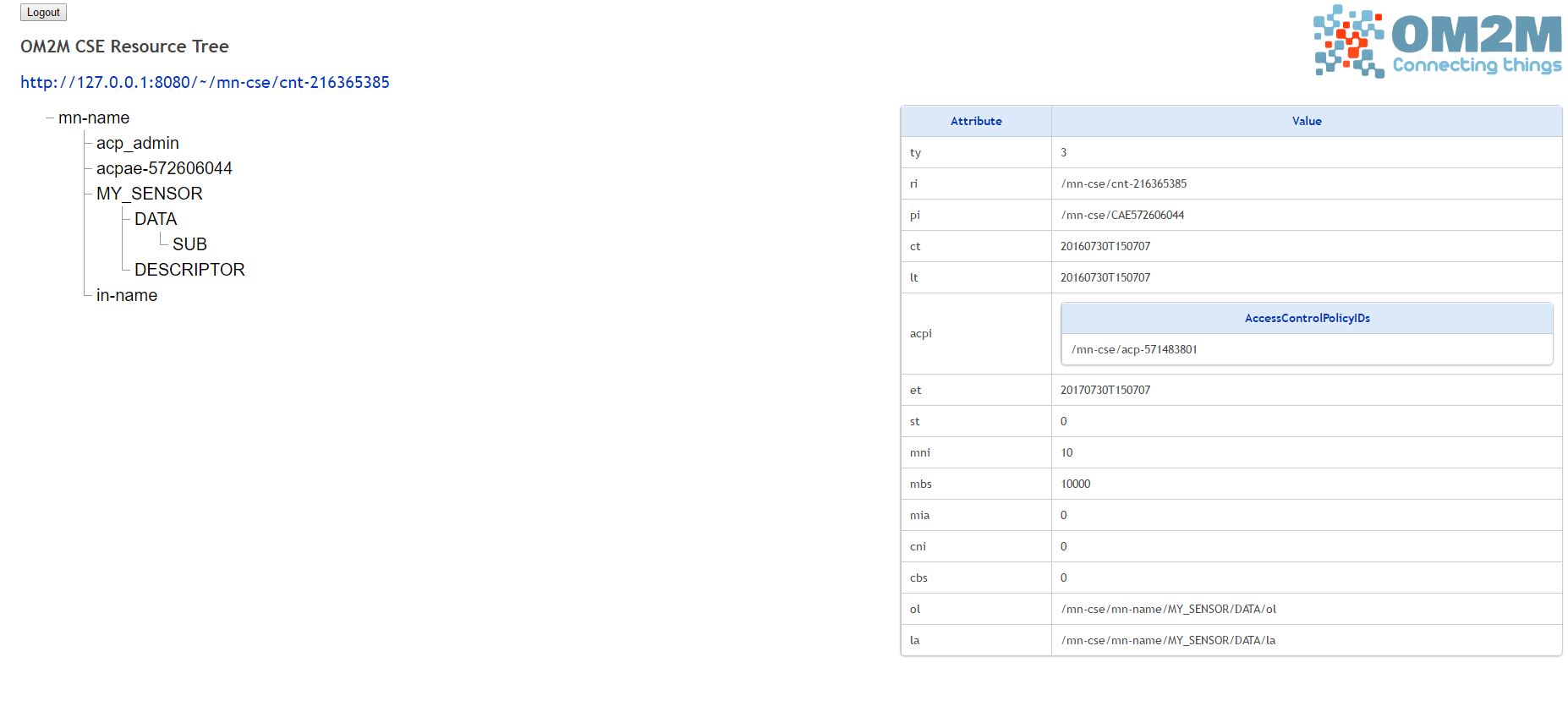

Hi everyone,
I have a situation like: AE MY_ACTUATOR in IN will subscribe to AE MY_SENSOR/DATA in MN. However when I run these two plugins, I got the 4103 error, like the log file below showed:
IN side:
[2016-07-30 15:06:30,957 INFO] - org.eclipse.om2m.binding.http.RestHttpServlet

[2016-07-30 15:07:02,471 INFO] - org.eclipse.om2m.core.Activator
IPE service discovered: actuator
[2016-07-30 15:07:02,472 INFO] - org.eclipse.om2m.core.router.Router
Received request in Router: RequestPrimitive [operation=1,
to=/in-cse,
from=admin:admin,
resourceType=2,
name=MY_ACTUATOR,
content=org.eclipse.om2m.commons.resource.AE@7c98d1b0,
returnContentType=application/obj,
requestContentType=application/obj,
[2016-07-30 15:07:02,473 INFO] - org.eclipse.om2m.core.router.Router
Request handling in the current CSE: /in-cse
[2016-07-30 15:07:02,475 INFO] - org.eclipse.om2m.core.router.Router
ResourceController to be used [AEController]
[2016-07-30 15:07:02,503 INFO] - org.eclipse.om2m.core.router.Router
Response in Router= ResponsePrimitive [responseStatusCode=2001,
content=org.eclipse.om2m.commons.resource.AE@516a09ea,
to=admin:admin,
from=/in-cse,
location=/in-cse/CAE810686368,
[2016-07-30 15:07:07,749 INFO] - org.eclipse.om2m.binding.http.RestHttpServlet
[2016-07-30 15:07:07,750 INFO] - org.eclipse.om2m.binding.http.RestHttpServlet
Built RequestPrimitive: RequestPrimitive [to=/in-cse/in-name/MY_ACTUATOR,
content=<?xml version="1.0" encoding="UTF-8"?>
<m2m:sgn xmlns:m2m="http://www.onem2m.org/xml/protocols">
<vrq>true</vrq>
<sud>false</sud>
</m2m:sgn>
[2016-07-30 15:07:07,751 INFO] - org.eclipse.om2m.binding.http.RestHttpServlet
Content type headers: application/xml
Header value: application/xml
Accept header: application/xml
[2016-07-30 15:07:07,751 INFO] - org.eclipse.om2m.core.router.Router
Received request in Router: RequestPrimitive [operation=5,
from=/mn-cse,
<vrq>true</vrq>
<sud>false</sud>
</m2m:sgn>
returnContentType=application/xml,
requestContentType=application/xml,
queryStrings={}]
[2016-07-30 15:07:07,752 INFO] - org.eclipse.om2m.core.router.Router
Request handling in the current CSE: /in-cse/in-name/MY_ACTUATOR
[2016-07-30 15:07:07,755 INFO] - org.eclipse.om2m.core.router.Router
OM2M exception caught in Router: Unknown or unauthorized originator
Response in Router= ResponsePrimitive [responseStatusCode=4103,
content=Unknown or unauthorized originator,
to=/mn-cse,
from=/in-cse,
contentType=text/plain,
MN side:

I think the problem came from my POA and NU address. In MY_SENSOR, I set the NU address to be the address that the notification message need to be sent to, in this case this is the address of AE MY_ACTUATOR:
Subscription sub = new Subscription();
sub.getNotificationURI().add("/in-cse/in-name/MY_ACTUATOR");
And about the POA address, I am still abit confused how to set it correctly, so I kept it to be my ipeId, in this case is sample, like in the tutorial in the OM2M website:
ae.getPointOfAccess().add(ipeId);
I think the problem came from here. Does anyone have an idea how to fix this error?
Thank you so much
Son
