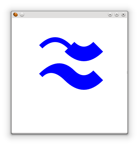

Re: [GEF4] Calculation of stroke outline in model [message #1735279 is a reply to message #1735200] Thu, 16 June 2016 22:02 Go to previous messageGo to next message
Colin Sharples is currently offline Colin SharplesFriend
Messages: 90
Registered: July 2009
Location: Wellington, New Zealand
Member
Ah, so that's what a hodograph is used for, I wondered about that Smile
Thanks Matthias, that's really cool. Actually, the shapes I'm joining together are constructed from QuadraticCurves rather than lines, so I have modified your example to create a PolyBezier from two new curves using the calculated offsets - I also offset the curve's control point in a similar manner to the start and end offsets. That produces a really beautiful effect, just what I was looking for. GEF4 rocks!

public class QuadCurveOffsetSnippet extends Application {
    launch();
  protected void addCurves(Pane root, double y, boolean transition) {
    // create curves
    QuadraticCurve firstCurve = new QuadraticCurve(100, y, 150, y - 50, 200, y);
    BezierCurve secondCurve = new QuadraticCurve(200, y, 250, y + 50, 300, y);
    // create paths
    Path firstPath = Geometry2Shape.toPath(firstCurve.toPath());
    Path secondPath = Geometry2Shape.toPath(secondCurve.toPath());
    // strokes
    double firstStrokeWidth = 16;
    double secondStrokeWidth = 48;
    // configure strokes
    firstPath.setStrokeType(StrokeType.CENTERED);
    firstPath.setStrokeWidth(firstStrokeWidth);
    firstPath.setStrokeLineCap(StrokeLineCap.BUTT);
    firstPath.setStrokeLineJoin(StrokeLineJoin.BEVEL);
    firstPath.setStroke(Color.BLUE);
    secondPath.setStrokeType(StrokeType.CENTERED);
    secondPath.setStrokeWidth(secondStrokeWidth);
    secondPath.setStrokeLineCap(StrokeLineCap.BUTT);
    secondPath.setStrokeLineJoin(StrokeLineJoin.BEVEL);
    secondPath.setStroke(Color.BLUE);
    // compute polygons to transition from the thinner/first curve to
    // the thicker/second curve
    if (transition) {
      // compute start point and end point
      Point startPoint = firstCurve.get(0);
      Point endPoint = firstCurve.get(1);
      Point controlPoint = firstCurve.getCtrl();
      // compute curve normals for start point and end point
      Vector startNormal = new Vector(firstCurve.getDerivative().get(0)).getOrthogonalComplement().getNormalized();
      Vector endNormal = new Vector(firstCurve.getDerivative().get(1)).getOrthogonalComplement().getNormalized();
      // compute left and right offset points for the start point (first
      // curve stroke width)
      Point startOffsetLeft = startPoint.getTranslated(startNormal.getMultiplied(firstStrokeWidth / 2).toPoint());
      Point startOffsetRight = startPoint.getTranslated(startNormal.getMultiplied(firstStrokeWidth / 2).toPoint().getNegated());
      // compute left and right offset points for the quadratic curve control point
      Point ctrlOffsetLeft = controlPoint.getTranslated(startNormal.getMultiplied(firstStrokeWidth / 2).toPoint());

Hey that looks cool indeed!
I manipulated the code further to accurately align the shapes:
- Compute control points for cones so that C1 continuity is achieved.
- Set stroke to transparent for the cones to properly align the shapes.

			// add to scene
			root.getChildren().addAll(leftConeShape, capShape, rightConeShape);
Screenshot:
index.php/fa/26197/0/
Matthias
[Updated on: Fri, 17 June 2016 08:34]

Awesome, that looks great. I also tried the same approach on calculating the fat outline - it's pretty good except for the degenerate case where the control point is actually on the curve (i.e. it's really a straight line). In that case I just calculated the offset as the midpoint between the two curve offset points. Apart from that, it gives a really good fat outline - on very wide lines with sharp curves, it overestimates the control points just a bit, but otherwise a very good fit, and with excellent performance.
