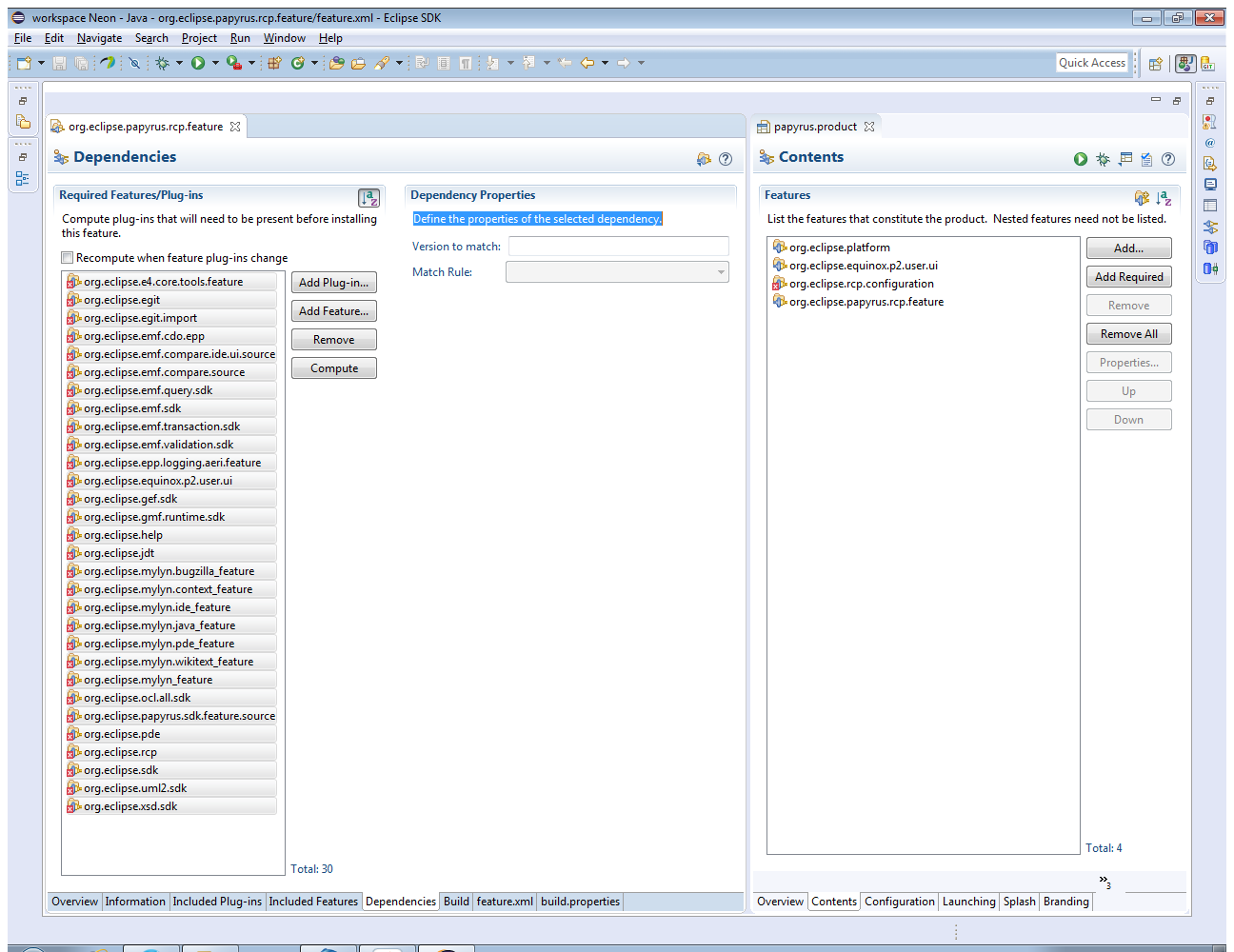

I have difficulties to export Papyrus as a standalone product.
I downloaded Eclipse Neon, installed Papyrus and cloned the git master branch in order to the import the plug-in corresponding to the Papyrus RCP application.
In "releng/rcp" directory, I found and imported org.eclipse.papyrus.rcp.product.
But in papyrus.product contents tab, org.eclipse.rcp.configuration and org.eclipse.papyrus.rcp.feature can apparently not be resolved.
Can somebody tell me what's wrong with org.eclipse.rcp.configuration ? Am I missing something in my Eclipse installation ?
For the second one, I imported org.eclipse.papyrus.rcp.feature but its feature.xml dependencies tab fails to resolve the whole list of 30 features.
index.php/fa/26143/0/
I completed my installation. All the required features appear in my Eclipse installation. Still, they are not found in features.xml.
Any idea why ?
Laurent

Hi Laurent,
Can you explain what you are trying to achieve?
If it's to create a product on top of Papyrus with your custom plugins
you should probably have a look here
https://git.eclipse.org/c/papyrus/org.eclipse.papyrus-informationmodeling.git
or
https://git.eclipse.org/c/papyrus/org.eclipse.papyrus-sysml.git/
you will have example of custom product just run mvn clean install -Pproduct at the root of the repo
For your specific problem, some information
- what is the text in your problem view?
- what target platform are you using?
- the product is also incorporating elements that are not technically required by papyrus sdk but that are handy to have in papyrus product
=> did you installed UML2 SDK, Mylyn, JDT
- the integration command to build the product is
mvn clean verify -f releng/rcp/pom.xml
with specific values for
eclipse.download=...
target.suffix=eclipse
papyrus.repo.main=...
- you can download the official rcp (nightly for neon) and use it to open your workspace https://eclipse.org/papyrus/download.html

Hi benoit,
I am currently experimenting with Papyrus. I may have to work on a product on top of it. But right now, I just want to see whether I can modify the code and export the result as a product.
I have nothing displayed in my problem view. Target platform is Neon. And yes, I did install the 'handy' elements (actually all the 30 features that can not be resolved...).
Do I have to use Maven (I will if necessary !) or is possible to 'just' use papyrus.product in org.eclipse.papyrus.rcp.product to export the application with my modifications ?
Thank you for the links,
Laurent
