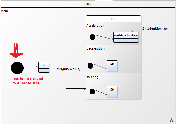

I am usuing SIrius (based on GMF) to develope a modelling environment for an SDL. I have installed elk and I could see that it does auto-layout for my diagrams, how ever it automatically resizes the node as shown in the below image Sad
index.php/fa/25462/0/
Do you have any idea why this is happening ? I have found some other guys also had this issue and apparently it because of the border spacing option of the layout option which is 12 by default.
Now, I need some help on how to override the default values for the layout options (maybe using extension points). I have check the video on youtube but it uses staticConfig as the extension point, which is not available anymore due to the reconstruction of elk.
I found this elk very interesting but since it resizes the nodes I can't use it right now Sad

The easiest way to statically configure the layout would be to set the properties in your custom IDiagramLayoutConnector implementation, e.g. by subclassing GmfDiagramLayoutConnector:
https://github.com/eclipse/elk/blob/master/plugins/org.eclipse.elk.conn.gmf/src/org/eclipse/elk/conn/gmf/GmfDiagramLayoutConnector.java
That implementation is registered with an ILayoutSetup in the org.eclipse.elk.core.service.layoutConnectors extension point, see GmfLayoutSetup.
In this case you can force the respective nodes to keep their original size by setting the option CoreOptions.NODE_SIZE_CONSTRAINTS to SizeConstraint.fixed().
Re: Node Resize when doing auto layout [message #1727993 is a reply to message #1727991] Wed, 30 March 2016 02:56 Go to previous message
Example:
public class MyLayoutConnector extends GmfDiagramLayoutConnector {
    protected KNode createNode(LayoutMapping mapping, ShapeNodeEditPart nodeEditPart,
            IGraphicalEditPart parentEditPart, KNode parentKNode, Maybe<KInsets> kinsets) {
        KNode node = super.createNode(mapping, nodeEditPart, parentEditPart, parentKNode, kinsets);
        if (nodeEditPart instanceof MySpecialEditPart) {
            KShapeLayout shapeLayout = node.getData(KShapeLayout.class);
            shapeLayout.setProperty(CoreOptions.NODE_SIZE_CONSTRAINTS, SizeConstraint.fixed());
        return node;
But beware! This is a very early stage of ELK and the APIs are likely to change further in the course of this year.
