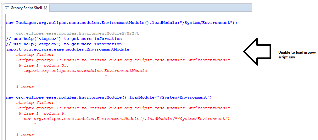

I have some questions regarding creating "Modules" and using "Groovy Interpreter". I am facing issues while using "Groovy interpreter". I have attached the images for your reference
Questions:
1. How to load groovy scripting interpreter
2. I have created "public class SampleProjectModule extends AbstractScriptModule {} "
3. Loading Groovy
Thank you in advance
Best Regards
Ningareddy
  • Attachment: Error1.png
    (Size: 22.61KB, Downloaded 310 times)
  • Attachment: Error2.jpg
    (Size: 76.96KB, Downloaded 130 times)

I guess the groovy engine might need an update on the external update site. Hope to get this fixed by end of this week. I will keep you informed. You may also open a bug on the github page to keep this issue tracked

fixed the update site of groovy components. Please update and give it a try.
