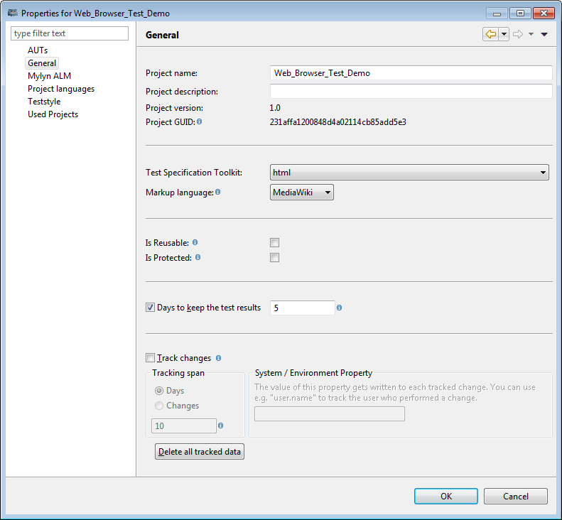

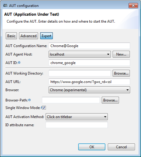

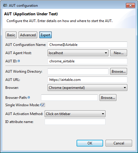

See the following attached image files for project/AUT configuration info:

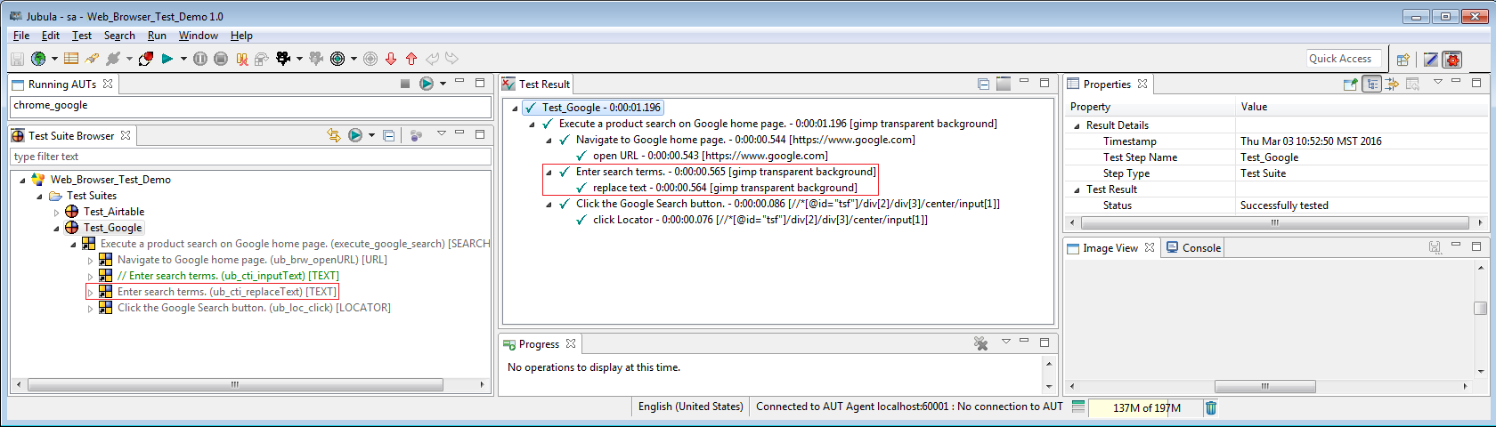

For example, the inputText and replaceText actions work correctly when they are used in tests on the Google web site (ww.google.com) to enter text in the home page search text input field. (See test results in the attached Jubula_WebBrowserAUT_GoogleWebSiteTestResults.png image file.) The ub_cti_replaceText action also works correctly (no surprise) in the Jubula Samples Simple Adder HTML tests.

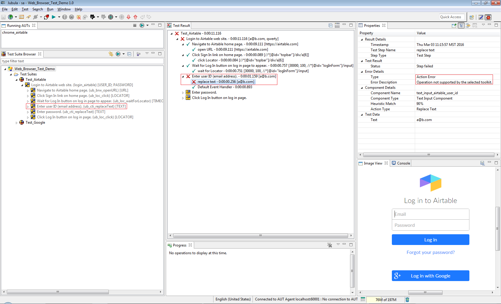

However, if I perform a similar test, to enter text in the Sign In page Email text input field on the the Airtable web site (airtable.com), the test fails for either of the inputText or replaceText test cases. (See test results in the attached Jubula_WebBrowserAUT_AirtableWebSiteTestResults.png image file.)

If you look at the image file Jubula_WebBrowserAUT_AirtableWebSiteTestResults.png in my OP, you will notice that the test results screen image shows that the AirTable "Sign In" page has two input fields: one for an email address (type="email") and, below it, one for a password (type="password"). In my original AirTable test suite, I naturally tried to enter the email address first, since that is the first input field on the page. That is where my test failed. To modify the test suite, I set as inactive the test case step that enters an email address in the first input field, so that the test now only tries to enter text into the Password input field.
When I ran the test, it successfully entered a text string in the Password input field. So, only the Email input field (whose input tag uses the type="email" attribute) causes the error.
I conclude that, to correct the problem, the Jubula ComponentConfiguration.xml file needs a new entry added for a html.forms.input.Email toolkit component and the TextImplCass tester class will need to be updated to implement that new specification.
