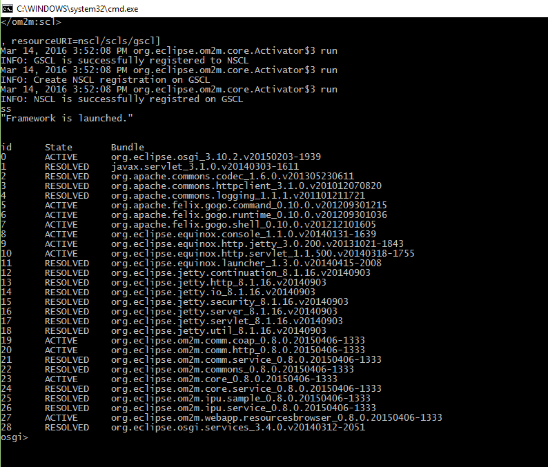

Mais lorsque je veux vérifier dans la console du gscl ,en tapant ss je n'ai pas trouvé "org.eclipse.om2m.sample ipu"
J'ai répété le tutoriel plusieurs fois mais j'ai trouvé les même résultats!!!

It seems I am having the same problem.. I have already tried the alternative of running as maven clean after maven install..the "org.eclipse.om2m.sample.ipu" was saved in the GSCL product file but the wasn't displayed on the GSCL consoleindex.php/fa/25300/0/index.php/fa/25301/0/

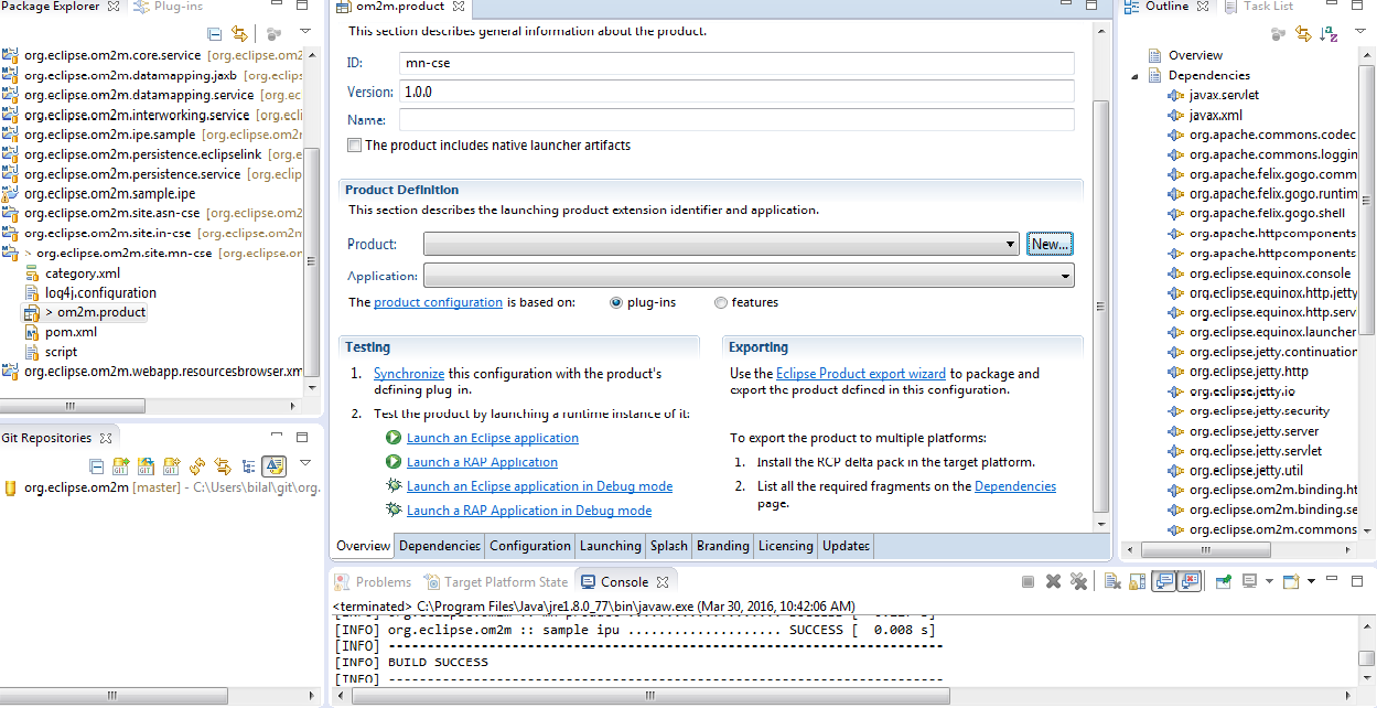

Hi I am having issues adding the plugin in mn-cse (because there is no gscl in my workspace or in directories). I have sample.ipu in my builds but I cannot figure out how to add the plugin into om2m.product file of mn-cse of my workspace. I am attaching the screenshot of what I get when I open the om2m.product file
index.php/fa/25465/0/
  • Attachment: Untitled.png
    (Size: 99.55KB, Downloaded 1298 times)

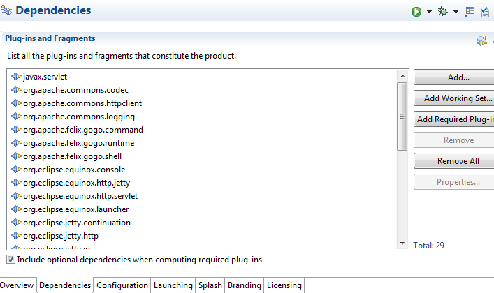

Re: add your plugin [message #1728002 is a reply to message #1727980] Wed, 30 March 2016 03:36 Go to previous messageGo to next message
Dear Muhammed,
The "GSCL" entity was defined in the previous standard: SmartM2M. It is equivalent to the "MN-CSE" entity defined in the new standard: oneM2M.
You need to click on the "dependencies" tab of your "mn-cse" product (on top of your console), then add your plugin.
Mahdi
Re: add your plugin [message #1728014 is a reply to message #1728002] Wed, 30 March 2016 05:13 Go to previous messageGo to next message
got it to work thanks alot!!!

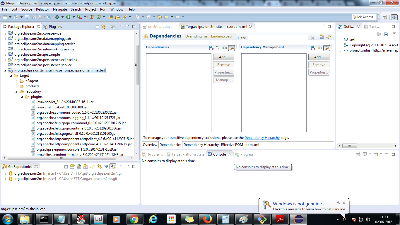

Re: add your plugin [message #1733902 is a reply to message #1728196] Thu, 02 June 2016 02:03 Go to previous messageGo to next message
Hi Mahdi,
I am trying to add coap binding files in to the IN-CSE plugins. but i am not aware how to add. Coulg you please help me how to add californium-0.18.6-final.jar and element-connector-0.2-final.jar in to IN-CSE plugins and also please explain if add these two jar files in to the IN-CSE which means that my IN-CSE starts using the COAP protocol instead of HTTP if not please help me what are the changes need to done to make it use COAP protocol.
Nithyananth
  • Attachment: coap.png
    (Size: 188.86KB, Downloaded 614 times)
