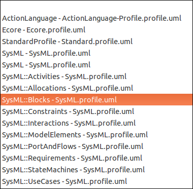

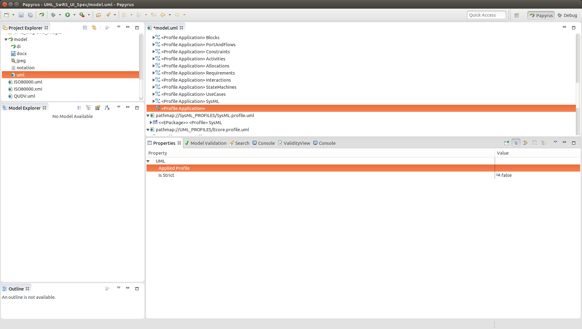

Hi Ed,
I am using Mars.3(4.5.3) shipped with the latest stable Papyrus.
I have tried your suggestion to edit the uml file using UML Model Editor, but when I try to apply a new profile I cannot find the profile OCLforUML listed as you can see from the following images.
index.php/fa/25053/0/
These is the list of profiles available as value of the field Applied Profile:
index.php/fa/25054/0/
Roberto
[Updated on: Sat, 20 February 2016 21:01] by Moderator

Select a Package
UML Editor(on menu bar)->Package->Apply Profile...
Ed Willink
