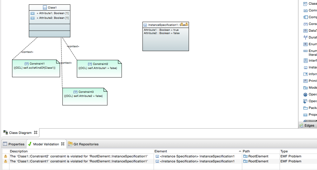

Hi All,
I cannot get my head around this.
I have created a class Class1 and an InstanceSpecification InstanceSpecfication:Class1
I have also create the following constraint for Class1:
self.oclIsTypeOf(Class1)
I was expecting it to be always verified, but when I validate the model I get that the constraint is violated.
If I replace the above OCL constraint with the following
self.oclIsTypeOf(UML:InstanceSpecification)
the model get validated
Also, If I execute the xText OCL console on InstanceSpecification1 I get
Evaluating:
self.oclType()
Results:
UML::InstanceSpecification

Here is the model that fails the validation
index.php/fa/24968/0/
OLC->Validate works on the Constraint. However, when I validate the entire model, it fails.
Roberto.

It looks as if you have too many different things named Class1, but you
don't make it easy to help.
See https://wiki.eclipse.org/OCL/ForumNetiquette
Ed Willink

https://bugs.eclipse.org/bugs/show_bug.cgi?id=487739 raised.
The problem is localized to the type-of an InstanceSpecification that is
different at M1 and M2. Try to avoid using the type-of. Probably
debugging of a real problem has caused you to fall into this confusing
trap.

Here is one of the problem that I am trying to solve.
Considering the following diagram:
index.php/fa/24987/0/
I want to use OCL to express that the type of the instance assigned to the attribute Block1.minPress has to be the same of the instance assigned to the attribute Block1.maxPress
However, the OCL constraint that I wrote always validates the model. Whereas it should not validate the model in the example given.
Please find the sample project attached as well.
Roberto.

I've taken a look at the oustanding bugs in this area and refreshed my
memory a bit. It is a very awkward area.
https://bugs.eclipse.org/bugs/show_bug.cgi?id=400090
https://bugs.eclipse.org/bugs/show_bug.cgi?id=439222
https://bugs.eclipse.org/bugs/show_bug.cgi?id=458326
https://bugs.eclipse.org/bugs/show_bug.cgi?id=458394
https://bugs.eclipse.org/bugs/show_bug.cgi?id=458395
Your example helps me see what is going wrong.
OCL evaluation on an InstanceSpecification is troublesome. Should "self" be
- an instance of the UML InstanceSpecification as would be the case for
any other evaluation using a mouse selection in a UML model to identify
the context
- an instance of one or all of the InstanceSpecification::classifier
types to allow navigation in the instance world
The non-Xtext OCL console provided Ecore/UML M1/M2 behavioral options.
It seems that we need a user choice as to whether the selection's
OclType is to be computed from within the model (e.g. using
InstanceSpecification::classifier) or from the metamodel (e.g. using
EObject::eClass() or OclAny::oclType()).
A choice to use model-determined OclType could make the OCL console
useful, and extensible to other contexts in which types are no isolated
in different metamodel layers.
Back to your problem. I think you should be using compatibility of
InstanceSpecification::classifier to check for consistent usage.
Attempting to subvert oclType()/oclIsKindOf()/oclIsTypeOf() for this
purpose is unnecessary and dangerous.
The Help->Contents OCL documentation provides tutorials, with some
reference to Papyrus.
Once the OCL Console has a model-determined OclType, you will be able to
use the debug button with the OCL Console to debug your evaluations.
Ed Willink

Thanks for your help.
However, I have not been able to solve my issue.
I am not able to understand what you mean by
Would you be able to provide me with the OCL constraint to use for the project testOCL2.zip described in my previous post?
In this way, I could use your solution to better understand how to use UML with Papyrus.

Hi Ed,
Thanks for your answer.
I have tried your suggestion but I was not successful.
I think that I am missing something.
So I recreated the issue by using UML only and I have attached a new project that you should be able to open with your Papyrus.
There is one conceptual thing that I think I am missing. From my understanding, all of the OCL constraint defined for a specific class in UML will be tested against InstanceSpecifications of this class only. It is only when the class in instantiated ( and I think you can do this only through an InstanceSpecification ) that the OCL constraint can be tested.
Am I missing something?
Roberto.

Yes. In principle InstanceSpecification gives you an ability to mix
Classes and Instances in a single diagram, and consequently OCL
associated with Classes can be exercised on the Instances. This
functionality is not defined by OMG and so an intuitive extrapolation is
evolving. Unfortunately there is no body of useful examples and creating
them in the UML Model Editor is not easy. Creating them within Papyrus
hits other limitations. In practice this boundary has been pushed by a
couple of sympathetic users. You are pushing a bit further and providing
the example that is needed to embarrass the developer(s). Thanks.

Hi Ed,
Thank you for your help.
Is OCL intended to be used to express meta-model constraints only? From my understanding, OCL can be used to express model constraints as well. Am I wrong?
Point 7.5,9 of the latest OCL spec, states that
The operation is oclIsTypeOf results in true if the type of self and t are the same. For example:
context Person
inv: self.oclIsTypeOf( Person ) -- is true
inv: self.oclIsTypeOf( Company) -- is false
So it appears to me that OCL is intended to work with the model as well.
Regarding your help for my specific problem:
If we stick to the metamodel level, the following works.
let a1 = self.slot->select(definingFeature.name =
'Attribute1').value->any(true).oclAsType(InstanceValue) in
let a2 = self.slot->select(definingFeature.name =
'Attribute2').value->any(true).oclAsType(InstanceValue) in
a1.instance.classifier = a2.instance.classifier
This works if I type it in the Xtext OCL Console, but it does not work if I use it in a Constraint block associated to a specific class.
I have attached the new project sample modified for you reference.
Roberto

Hi Roberto,
Yes, but an InstanceSpecification is not an Instance. It is at the same meta-level than the Class it is typed with.
The constraints defined in UML apply to both Class and InstanceSpecification
The constraints defined in UML Profiles apply to both Class and InstanceSpecification
The constraints defined in a specific UML Model, on a Class, apply to the instances of that Class. But UML doesn't define the instance level (It may typically be generated code)
The validation of Class' constraints on InstanceSpecifications is thus non-normative, and only a best-effort support is provided. There is a lot of confusion (and disagreement) about the notion of Instance/InstanceSpecification in UML 2
Camille

Hi Roberto,
Interesting discussion you started Smile To make the problem/discussion more concrete from an end-user point-of-view (besides the interesting developers comments above), have a look at a variation of your 'original model' (see attached screenshot and example project.).
index.php/fa/25010/0/
You will probably notice that (with the "current" versions of the tooling), some things are hard to explain:
- The 'behavior' of Constraint2 and 3 probably makes sense to you (Constraint2 is reported to be violated, Constraint3 is not). This behaviour indeed 'makes sense' to everyone, but is not defined explicitly in the current specs.
- The behavior of Constraint1 didn't make sense to you (nor does it to me), and indeed it is not inline with the rest of the behaviour as currently implemented by the tooling. However, from a spec perspective, there is no problem since the spec is underdefined...
In case you have a lot of time, you might find the discussion at https://bugs.eclipse.org/bugs/show_bug.cgi?id=417062 useful Smile
On a related matter, the mission of the just started Papyrus Industrial Consortium (https://polarsys.org/wiki/Papyrus_IC) states that
The Papyrus IC is an open consortium that focuses on the development of a customizable and extensible industrial-grade open source model-based engineering tool suite based on the Papyrus/Eclipse platform, other key open source technologies, and leading industry standards (see Vision/Mission below).
I think your problem is a very concrete and useful example of where things go wrong on the last part of that sentence, and where users and developers should not put our heads into the sand and state: It's not in the spec, so we shouldn't implement this. (Shameless add: This said, you're welcome to join the consortium Smile ).
@Ed: Really appreciate the effort you put into this!

>> Hi Roberto,
>> Interesting discussion you started :) To make the problem/discussion
>> https://bugs.eclipse.org/bugs/show_bug.cgi?id=417062 useful :)
>> Quote:
>> This said, you're welcome to join the consortium :) ).

First, I have to specify that I never encountered this exact issue before myself, ie. I never came across a situation in which I added a constraint in a UML model in the context of a class, in which I used the oclIsTypeOf()/oclIsKindOf() operations. As such, I also had a closer look at the model from https://www.eclipse.org/forums/index.php?t=msg&th=1074705&goto=1723305&#msg_1723305
I found the constructs used in that model a bit 'unnatural': both cmH2O-PRESS and Pa-PRESS generalize PRESS, but in fact, they only differ in the sense that different stereotypes are applied to cmH2O-PRESS and Pa-PRESS. So I went to have a look at the SysML spec, but I didn't find a good answer in there (figure E.13 does specify the relationship between gram and kilogram, but only on a unit level, and I find no hints on what to do with the related Valuetypes in the spec [*].
However (now starts the interesting part), this particular annex of the SysML standard (QUDV) defines a model-library. As such, figure E.5 shows that the referenceUnit property points to the unit Class. As you could see in Roberto's original diagram, units in SysML models are (according to the spec) to be modeled as InstanceSpecifications. Now, have a look at constraint [1] on page 261. It states,
package QUDV
   context PrefixedUnit
   inv: not referenceUnit.oclIsTypeOf(PrefixedUnit)
   endpackage
If I interpret this correctly, this constraint does exactly the same as the one mentioned originally in this thread: i.e. it is defined in the context of a class, and it is meant to be evaluated on an instancespecification (a particular unit) . So, it seems like the spec at least implicitly acknowledges this particular form of constraint evaluation???. Moreover, looking at the rest of annex E, I wonder
  • who created the whole lot of OCL constraints present in annex E?
  • which tool he/she used to create/test these constraints (assuming it is impossible to do this without tool support)?
So, to summarize my thoughts:
  • From a modeling point of view, the person that specifies the OCL constraints, works in the context of a class, and hence the use of oclIsTypeOf() really makes sense, and the oclAsModelType() operation complicates matters. However, I repeat that I never encountered such a use case myself, so this might be only for specialists
  • From an evaluation perspective, I understand the difficulty tool builders face (and hence the reason for introducing a dedicated operation (oclAsModelType()), yet I wonder how other toolbuilders have solved this (if they did).
Do you also consider the oclAsModelType() operation as a 'workaround' until the OCL-evaluator is 'smart enough' to decide on the appropriate metalevel M1/M2 itself?

SysML QUDV was modeled by Nicolas Rouquette using OCLinEcore. He fired
some early attempts off to me, and
GIT\org.eclipse.ocl\tests\org.eclipse.ocl.examples.xtext.tests\model\SysML_ValueTypes_QUDV.ecore
is one of the Eclipse OCL regression test cases for Java code generation.
I don't how out of date the test case model is but we certainly got to a
no-problems state.
All this oclAsModelType stuff is need solely for the case of navigating
from an object of type InstanceSpecification where there is a
classification ambiguity. This is very rare; if I had realized how rare,
I would have kicked this problem off into the long grass, but since
we're nearly there, I'll finish it. NB Class constraints do not navigate
from an object of type InstanceSpecification; they navigate in the
disciplined world of Class instances and Properties.
The OCL parser will never be smart enough to distinguish M1/M2
automatically; certainly not for the pathological case of an
InstanceSpecification instantiating an InstanceSpecifcation. Some form
of explicit selection is needed. A Console menu option is bad since it
gets lost in alternative OCL contexts such as the debugger. An OCL
operation is good since it is there for all purposes. I see only
spelling to discuss.
The original problem is now solved by the Class invariant
self.Attribute1.oclModelTypes() = self.Attribute2.oclModelTypes()
which lifts the explicit solution for an InstanceSpecification
with all its Slots and InstanceValues into the abstract world of Class
instances with Properties.
Much confusion was caused on this thread by attempting to practice the
constraint in the OCL console with an InstanceSpecification of Class1
rather than an instance of Class1 as the prevailing selection. The
solution may be practised in the console by:
let this = self.oclAsModelType(Class) in
this.Attribute1.oclModelTypes() = this.Attribute2.oclModelTypes()
When validating the Class1 constraint the evaluator knows that it is
dealing with an instance of Class1. The console does not know this and
so needs to be told. There will be a suppressable popup information
message in the Console recommending the use of an "let this =
self.oclAsModelType" wrapper whenever the selection has non-null
oclModelTypes(). No mysterious menu pull-downs.
Ed Willink
