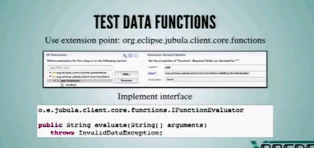

I am using Jubula for awhile and want to know about the extensions point, org.eclipse.jubula.client.core.functions. What are its capabilities? Like retrieving test data from url...?
i was watching this
https://www.youtube.com/watch?v=prNt5_LhXdo
To infinity and beyond -- making Jubula surpass its limits (presented by Bredex)

You can use the extension point to add your own functions for use as test data. Jubula comes with various functions out of the box [1] and this extension point lets you add your own. There are reference implementations in there.
Hope that helps!
Alex
[1] http://help.eclipse.org/mars/topic/org.eclipse.jubula.client.ua.help/content/html/userManual/tasks/workWithData/using-functions-as-data-for-test-cases.html?cp=44_2_12_5
