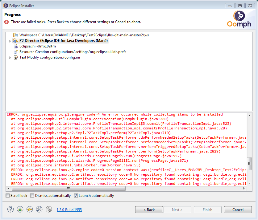

Hello,
when installing eclipse with the installer version 1.3.0 Build 1995 i get following error
How do I correct this ?
I attach a screenshot of my P2 Director task , since it fails there.
An error was detected while performing the engine operation and the changes are being rolled back. See the log for details.
ERROR: org.eclipse.equinox.p2.engine code=4 An error occurred while collecting items to be installed
  at org.eclipse.oomph.util.OomphPlugin.coreException(OomphPlugin.java:280)
  at org.eclipse.oomph.p2.internal.core.ProfileTransactionImpl$3.commit(ProfileTransactionImpl.java:523)
  at org.eclipse.oomph.p2.internal.core.ProfileTransactionImpl.commit(ProfileTransactionImpl.java:328)
  at org.eclipse.oomph.setup.p2.impl.P2TaskImpl.perform(P2TaskImpl.java:710)
  at org.eclipse.oomph.setup.internal.core.SetupTaskPerformer.doPerformNeededSetupTasks(SetupTaskPerformer.java:3025)
  at org.eclipse.oomph.setup.internal.core.SetupTaskPerformer.performNeededSetupTasks(SetupTaskPerformer.java:2954)
  at org.eclipse.oomph.setup.internal.core.SetupTaskPerformer.performTriggeredSetupTasks(SetupTaskPerformer.java:2935)
  at org.eclipse.oomph.setup.internal.core.SetupTaskPerformer.perform(SetupTaskPerformer.java:2829)
  at org.eclipse.oomph.setup.ui.wizards.ProgressPage$9.run(ProgressPage.java:552)
  at org.eclipse.oomph.setup.ui.wizards.ProgressPage$11$1.run(ProgressPage.java:671)
  at org.eclipse.core.internal.jobs.Worker.run(Worker.java:55)
  ERROR: org.eclipse.equinox.p2.engine code=0 session context was:(profile=C__Users_EMAKMEL_Desktop_Test2Eclipse_lhs-git-main-master2_eclipse, phase=org.eclipse.equinox.internal.p2.engine.phases.Collect, operand=, action=).
  ERROR: org.eclipse.equinox.p2.artifact.repository code=0 No repository found containing: osgi.bundle,org.eclipse.egit,4.1.1.201511131810-r
  ERROR: org.eclipse.equinox.p2.artifact.repository code=0 No repository found containing: osgi.bundle,org.eclipse.egit.core,4.1.1.201511131810-r
  ERROR: org.eclipse.equinox.p2.artifact.repository code=0 No repository found containing: osgi.bundle,org.eclipse.egit.doc,4.1.1.201511131810-r
  ERROR: org.eclipse.equinox.p2.artifact.repository code=0 No repository found containing: org.eclipse.update.feature,org.eclipse.egit,4.1.1.201511131810-r
  ERROR: org.eclipse.equinox.p2.artifact.repository code=0 No repository found containing: org.eclipse.update.feature,org.eclipse.egit.mylyn,4.1.1.201511131810-r
  ERROR: org.eclipse.equinox.p2.artifact.repository code=0 No repository found containing: osgi.bundle,org.eclipse.egit.mylyn.ui,4.1.1.201511131810-r
  ERROR: org.eclipse.equinox.p2.artifact.repository code=0 No repository found containing: osgi.bundle,org.eclipse.egit.ui,4.1.1.201511131810-r
  ERROR: org.eclipse.equinox.p2.artifact.repository code=0 No repository found containing: osgi.bundle,org.eclipse.jgit,4.1.1.201511131810-r
  ERROR: org.eclipse.equinox.p2.artifact.repository code=0 No repository found containing: osgi.bundle,org.eclipse.jgit.archive,4.1.1.201511131810-r
  ERROR: org.eclipse.equinox.p2.artifact.repository code=0 No repository found containing: org.eclipse.update.feature,org.eclipse.jgit,4.1.1.201511131810-r
Took 9 seconds.
There are failed tasks.
  • Attachment: Captsure.PNG
    (Size: 63.33KB, Downloaded 1196 times)
  • Attachment: Caspture.PNG
    (Size: 62.99KB, Downloaded 999 times)
[Updated on: Fri, 04 December 2015 10:59]
Re: installation error [message #1716493 is a reply to message #1716481] Fri, 04 December 2015 11:45 Go to previous messageGo to next message
Eike Stepper is currently offline Eike StepperFriend
Messages: 6693
Hi Maksim,
It's possible that that was a temporary problem with http://download.eclipse.org/egit/updates (most likely non-atomic
repo modifications) . Can you please try it again and tell us if the problem persists?
Cheers
/Eike

Ed Merks is currently offline Ed MerksFriend
Messages: 33264
It's hard to say much with only snippets from the log. I assume you've redirected all update sites, otherwise you've have a network failure. So instead you have a resolution value...
That version (osgi.bundle,org.eclipse.mylyn.wikitext.mediawiki.core.ant,2.10.1.v20161129-1925) should be in Neon, based on using this approach to search for it:
https://wiki.eclipse.org/Eclipse_Oomph_Authoring#How_to_find_a_P2_repository_at_Eclipse_using_the_Repository_Explorer
Note that Neon is a composite, so I assume you've mirrored all the children. In any case, you can use the repository explorer to browse your mirrors to be sure they contain what you expect.

Re: installation error [message #1756315 is a reply to message #1756313] Wed, 15 March 2017 10:20 Go to previous messageGo to next message
Jasmin Kling is currently offline Jasmin KlingFriend
Messages: 8
Registered: December 2016
Yes I redirected all update sites.
I searched for the plugin osgi.bundle,org.eclipse.mylyn.wikitext.mediawiki.core.ant in my local mirrored repository and it is there.
However it is not present in the artifacts.xml file.
I mirrrored the Neon site with these commands:
eclipse -nosplash -verbose -consoleLog -application org.eclipse.equinox.p2.artifact.repository.mirrorApplication -source http://download.eclipse.org/releases/neon/201612211000 -destination file:/D:/p2/neon
eclipse -nosplash -verbose -consoleLog -application org.eclipse.equinox.p2.metadata.repository.mirrorApplication -source http://download.eclipse.org/releases/neon/201612211000 -destination file:/D:/p2/neon
Did I miss anything?
Re: installation error [message #1756316 is a reply to message #1756315] Wed, 15 March 2017 10:50 Go to previous messageGo to next message
Messages: 8
Running the above commands again actually fixed the issue.
Thanks for your help!

ERROR: org.eclipse.equinox.p2.artifact.repository code=0 No repository found containing: osgi.bundle,org.eclipse.e4.ui.widgets.source,1.1.100.v20160506-0759
ERROR: org.eclipse.equinox.p2.artifact.repository code=0 No repository found containing: osgi.bundle,org.eclipse.e4.ui.workbench,1.4.0.v20160517-1624
ERROR: org.eclipse.equinox.p2.artifact.repository code=0 No repository found containing: osgi.bundle,org.eclipse.e4.ui.workbench.addons.swt,1.2.101.v20170206-1129
ERROR: org.eclipse.equinox.p2.artifact.repository code=0 No repository found containing: osgi.bundle,org.eclipse.e4.ui.workbench.addons.swt.source,1.2.101.v20170206-1129
ERROR: org.eclipse.equinox.p2.artifact.repository code=0 No repository found containing: osgi.bundle,org.eclipse.e4.ui.workbench.renderers.swt,0.14.1.v20170117-1415
ERROR: org.eclipse.equinox.p2.artifact.repository code=0 No repository found containing: osgi.bundle,org.eclipse.e4.ui.workbench.renderers.swt.source,0.14.1.v20170117-1415
ERROR: org.eclipse.equinox.p2.artifact.repository code=0 No repository found containing: osgi.bundle,org.eclipse.e4.ui.workbench.source,1.4.0.v20160517-1624
ERROR: org.eclipse.equinox.p2.artifact.repository code=0 No repository found containing: osgi.bundle,org.eclipse.e4.ui.workbench.swt,0.14.1.v20160829-0832
ERROR: org.eclipse.equinox.p2.artifact.repository code=0 No repository found containing: osgi.bundle,org.eclipse.e4.ui.workbench.swt.source,0.14.1.v20160829-0832
ERROR: org.eclipse.equinox.p2.artifact.repository code=0 No repository found containing: osgi.bundle,org.eclipse.e4.ui.workbench3,0.13.100.v20160506-0759
ERROR: org.eclipse.equinox.p2.artifact.repository code=0 No repository found containing: osgi.bundle,org.eclipse.e4.ui.workbench3.source,0.13.100.v20160506-0759
ERROR: org.eclipse.equinox.p2.artifact.repository code=0 No repository found containing: osgi.bundle,org.eclipse.ecf,3.8.0.v20160823-2221
ERROR: org.eclipse.equinox.p2.artifact.repository code=0 No repository found containing: org.eclipse.update.feature,org.eclipse.ecf.core.feature,1.3.0.v20160823-2221
ERROR: org.eclipse.equinox.p2.artifact.repository code=0 No repository found containing: org.eclipse.update.feature,org.eclipse.ecf.core.ssl.feature,1.1.0.v20160823-2221
ERROR: org.eclipse.equinox.p2.artifact.repository code=0 No repository found containing: osgi.bundle,org.eclipse.ecf.filetransfer,5.0.0.v20160823-2221
ERROR: org.eclipse.equinox.p2.artifact.repository code=0 No repository found containing: org.eclipse.update.feature,org.eclipse.ecf.filetransfer.feature,3.13.2.v20160823-2221
ERROR: org.eclipse.equinox.p2.artifact.repository code=0 No repository found containing: org.eclipse.update.feature,org.eclipse.ecf.filetransfer.httpclient4.feature,3.13.2.v20160823-2221
ERROR: org.eclipse.equinox.p2.artifact.repository code=0 No repository found containing: org.eclipse.update.feature,org.eclipse.ecf.filetransfer.httpclient4.ssl.feature,1.1.0.v20160823-2221
ERROR: org.eclipse.equinox.p2.artifact.repository code=0 No repository found containing: org.eclipse.update.feature,org.eclipse.ecf.filetransfer.ssl.feature,1.1.0.v20160823-2221
ERROR: org.eclipse.equinox.p2.artifact.repository code=0 No repository found containing: osgi.bundle,org.eclipse.ecf.identity,3.7.0.v20160823-2221
ERROR: org.eclipse.equinox.p2.artifact.repository code=0 No repository found containing: osgi.bundle,org.eclipse.ecf.provider.filetransfer,3.2.200.v20160823-2221
ERROR: org.eclipse.equinox.p2.artifact.repository code=0 No repository found containing: osgi.bundle,org.eclipse.ecf.provider.filetransfer.httpclient4,1.1.100.v20160823-2221
ERROR: org.eclipse.equinox.p2.artifact.repository code=0 No repository found containing: osgi.bundle,org.eclipse.ecf.provider.filetransfer.httpclient4.ssl,1.1.0.v20160823-2221
ERROR: org.eclipse.equinox.p2.artifact.repository code=0 No repository found containing: osgi.bundle,org.eclipse.ecf.provider.filetransfer.ssl,1.0.0.v20160823-2221
ERROR: org.eclipse.equinox.p2.artifact.repository code=0 No repository found containing: osgi.bundle,org.eclipse.ecf.ssl,1.2.0.v20160823-2221
ERROR: org.eclipse.equinox.p2.artifact.repository code=0 No repository found containing: osgi.bundle,org.eclipse.emf.codegen,2.11.0.v20160526-0356
ERROR: org.eclipse.equinox.p2.artifact.repository code=0 No repository found containing: osgi.bundle,org.eclipse.emf.codegen.ecore,2.12.0.v20160526-0356
ERROR: org.eclipse.equinox.p2.artifact.repository code=0 No repository found containing: osgi.bundle,org.eclipse.emf.common,2.12.0.v20160420-0247
ERROR: org.eclipse.equinox.p2.artifact.repository code=0 No repository found containing: org.eclipse.update.feature,org.eclipse.emf.common,2.12.0.v20160420-0247
ERROR: org.eclipse.equinox.p2.artifact.repository code=0 No repository found containing: osgi.bundle,org.eclipse.emf.common.ui,2.11.0.v20160526-0356
ERROR: org.eclipse.equinox.p2.artifact.repository code=0 No repository found containing: osgi.bundle,org.eclipse.emf.databinding,1.3.0.v20160526-0356
ERROR: org.eclipse.equinox.p2.artifact.repository code=0 No repository found containing: osgi.bundle,org.eclipse.emf.ecore,2.12.0.v20160420-0247
ERROR: org.eclipse.equinox.p2.artifact.repository code=0 No repository found containing: osgi.bundle,org.eclipse.emf.ecore.change,2.11.0.v20160420-0247
ERROR: org.eclipse.equinox.p2.artifact.repository code=0 No repository found containing: osgi.bundle,org.eclipse.emf.ecore.edit,2.9.0.v20160526-0356
ERROR: org.eclipse.equinox.p2.artifact.repository code=0 No repository found containing: osgi.bundle,org.eclipse.emf.ecore.editor,2.12.0.v20160526-0356
ERROR: org.eclipse.equinox.p2.artifact.repository code=0 No repository found containing: org.eclipse.update.feature,org.eclipse.emf.ecore,2.12.0.v20160420-0247
ERROR: org.eclipse.equinox.p2.artifact.repository code=0 No repository found containing: osgi.bundle,org.eclipse.emf.ecore.xmi,2.12.0.v20160420-0247
ERROR: org.eclipse.equinox.p2.artifact.repository code=0 No repository found containing: osgi.bundle,org.eclipse.emf.edit,2.12.0.v20160526-0356
ERROR: org.eclipse.equinox.p2.artifact.repository code=0 No repository found containing: osgi.bundle,org.eclipse.emf.edit.ui,2.12.0.v20160526-0356
ERROR: org.eclipse.equinox.p2.artifact.repository code=0 No repository found containing: osgi.bundle,org.eclipse.emf.mwe.core,1.3.20.v201605261103
ERROR: org.eclipse.equinox.p2.artifact.repository code=0 No repository found containing: osgi.bundle,org.eclipse.emf.mwe.utils,1.3.20.v201605261103
ERROR: org.eclipse.equinox.p2.artifact.repository code=0 No repository found containing: osgi.bundle,org.eclipse.emf.mwe2.lib,2.9.0.v201605261103
ERROR: org.eclipse.equinox.p2.artifact.repository code=0 No repository found containing: osgi.bundle,org.eclipse.emf.mwe2.runtime,2.9.0.v201605261103
ERROR: org.eclipse.equinox.p2.artifact.repository code=0 No repository found containing: osgi.bundle,org.eclipse.epp.logging.aeri.core,2.0.4.v20170307-1435
ERROR: org.eclipse.equinox.p2.artifact.repository code=0 No repository found containing: org.eclipse.update.feature,org.eclipse.epp.logging.aeri.feature,2.0.4.v20170307-1435
ERROR: org.eclipse.equinox.p2.artifact.repository code=0 No repository found containing: osgi.bundle,org.eclipse.epp.logging.aeri.ide,2.0.4.v20170307-1435
ERROR: org.eclipse.equinox.p2.artifact.repository code=0 No repository found containing: osgi.bundle,org.eclipse.epp.mpc.core,1.5.4.v20170222-1921
ERROR: org.eclipse.equinox.p2.artifact.repository code=0 No repository found containing: org.eclipse.update.feature,org.eclipse.epp.mpc,1.5.4.v20170222-1941
ERROR: org.eclipse.equinox.p2.artifact.repository code=0 No repository found containing: osgi.bundle,org.eclipse.epp.mpc.help.ui,1.5.4.v20170201-1845
ERROR: org.eclipse.equinox.p2.artifact.repository code=0 No repository found containing: osgi.bundle,org.eclipse.epp.mpc.ui,1.5.4.v20170222-1941
ERROR: org.eclipse.equinox.p2.artifact.repository code=0 No repository found containing: osgi.bundle,org.eclipse.epp.package.rcp,4.6.3.20170314-1500
ERROR: org.eclipse.equinox.p2.artifact.repository code=0 No repository found containing: osgi.bundle,org.eclipse.equinox.app,1.3.400.v20150715-1528
ERROR: org.eclipse.equinox.p2.artifact.repository code=0 No repository found containing: osgi.bundle,org.eclipse.equinox.app.source,1.3.400.v20150715-1528
ERROR: org.eclipse.equinox.p2.artifact.repository code=0 No repository found containing: osgi.bundle,org.eclipse.equinox.bidi,1.0.0.v20160307-1318
ERROR: org.eclipse.equinox.p2.artifact.repository code=0 No repository found containing: osgi.bundle,org.eclipse.equinox.bidi.source,1.0.0.v20160307-1318
ERROR: org.eclipse.equinox.p2.artifact.repository code=0 No repository found containing: osgi.bundle,org.eclipse.equinox.common,3.8.0.v20160509-1230
ERROR: org.eclipse.equinox.p2.artifact.repository code=0 No repository found containing: osgi.bundle,org.eclipse.equinox.common.source,3.8.0.v20160509-1230
ERROR: org.eclipse.equinox.p2.artifact.repository code=0 No repository found containing: osgi.bundle,org.eclipse.equinox.concurrent,1.1.0.v20130327-1442
ERROR: org.eclipse.equinox.p2.artifact.repository code=0 No repository found containing: osgi.bundle,org.eclipse.equinox.console,1.1.200.v20150929-1405
ERROR: org.eclipse.equinox.p2.artifact.repository code=0 No repository found containing: osgi.bundle,org.eclipse.equinox.console.source,1.1.200.v20150929-1405
ERROR: org.eclipse.equinox.p2.artifact.repository code=0 No repository found containing: osgi.bundle,org.eclipse.equinox.ds,1.4.400.v20160226-2036
ERROR: org.eclipse.equinox.p2.artifact.repository code=0 No repository found containing: osgi.bundle,org.eclipse.equinox.ds.source,1.4.400.v20160226-2036
ERROR: org.eclipse.equinox.p2.artifact.repository code=0 No repository found containing: osgi.bundle,org.eclipse.equinox.event,1.3.200.v20160324-1850
ERROR: org.eclipse.equinox.p2.artifact.repository code=0 No repository found containing: osgi.bundle,org.eclipse.equinox.event.source,1.3.200.v20160324-1850
ERROR: org.eclipse.equinox.p2.artifact.repository code=0 No repository found containing: osgi.bundle,org.eclipse.equinox.frameworkadmin,2.0.300.v20160504-1450
ERROR: org.eclipse.equinox.p2.artifact.repository code=0 No repository found containing: osgi.bundle,org.eclipse.equinox.frameworkadmin.equinox,1.0.700.v20160102-2223
ERROR: org.eclipse.equinox.p2.artifact.repository code=0 No repository found containing: osgi.bundle,org.eclipse.equinox.frameworkadmin.equinox.source,1.0.700.v20160102-2223
ERROR: org.eclipse.equinox.p2.artifact.repository code=0 No repository found containing: osgi.bundle,org.eclipse.equinox.frameworkadmin.source,2.0.300.v20160504-1450
ERROR: org.eclipse.equinox.p2.artifact.repository code=0 No repository found containing: osgi.bundle,org.eclipse.equinox.http.jetty,3.3.0.v20160324-1850
ERROR: org.eclipse.equinox.p2.artifact.repository code=0 No repository found containing: osgi.bundle,org.eclipse.equinox.http.jetty.source,3.3.0.v20160324-1850
ERROR: org.eclipse.equinox.p2.artifact.repository code=0 No repository found containing: osgi.bundle,org.eclipse.equinox.http.registry,1.1.400.v20150715-1528
ERROR: org.eclipse.equinox.p2.artifact.repository code=0 No repository found containing: osgi.bundle,org.eclipse.equinox.http.registry.source,1.1.400.v20150715-1528
ERROR: org.eclipse.equinox.p2.artifact.repository code=0 No repository found containing: osgi.bundle,org.eclipse.equinox.http.servlet,1.3.1.v20160808-1329
ERROR: org.eclipse.equinox.p2.artifact.repository code=0 No repository found containing: osgi.bundle,org.eclipse.equinox.http.servlet.source,1.3.1.v20160808-1329
ERROR: org.eclipse.equinox.p2.artifact.repository code=0 No repository found containing: osgi.bundle,org.eclipse.equinox.jsp.jasper,1.0.500.v20150119-1358
ERROR: org.eclipse.equinox.p2.artifact.repository code=0 No repository found containing: osgi.bundle,org.eclipse.equinox.jsp.jasper.registry,1.0.300.v20130327-1442
ERROR: org.eclipse.equinox.p2.artifact.repository code=0 No repository found containing: osgi.bundle,org.eclipse.equinox.jsp.jasper.registry.source,1.0.300.v20130327-1442
ERROR: org.eclipse.equinox.p2.artifact.repository code=0 No repository found containing: osgi.bundle,org.eclipse.equinox.jsp.jasper.source,1.0.500.v20150119-1358
ERROR: org.eclipse.equinox.p2.artifact.repository code=0 No repository found containing: osgi.bundle,org.eclipse.equinox.launcher,1.3.201.v20161025-1711
ERROR: org.eclipse.equinox.p2.artifact.repository code=0 No repository found containing: osgi.bundle,org.eclipse.equinox.launcher.source,1.3.201.v20161025-1711
ERROR: org.eclipse.equinox.p2.artifact.repository code=0 No repository found containing: osgi.bundle,org.eclipse.equinox.launcher.win32.win32.x86_64,1.1.401.v20161122-1740
ERROR: org.eclipse.equinox.p2.artifact.repository code=0 No repository found containing: osgi.bundle,org.eclipse.equinox.p2.artifact.repository,1.1.500.v20160419-0834
ERROR: org.eclipse.equinox.p2.artifact.repository code=0 No repository found containing: osgi.bundle,org.eclipse.equinox.p2.artifact.repository.source,1.1.500.v20160419-0834
ERROR: org.eclipse.equinox.p2.artifact.repository code=0 No repository found containing: osgi.bundle,org.eclipse.equinox.p2.console,1.0.500.v20160504-1450
ERROR: org.eclipse.equinox.p2.artifact.repository code=0 No repository found containing: osgi.bundle,org.eclipse.equinox.p2.console.source,1.0.500.v20160504-1450
ERROR: org.eclipse.equinox.p2.artifact.repository code=0 No repository found containing: osgi.bundle,org.eclipse.equinox.p2.core,2.4.100.v20160419-0834
ERROR: org.eclipse.equinox.p2.artifact.repository code=0 No repository found containing: org.eclipse.update.feature,org.eclipse.equinox.p2.core.feature,1.3.203.v20170131-1444
ERROR: org.eclipse.equinox.p2.artifact.repository code=0 No repository found containing: org.eclipse.update.feature,org.eclipse.equinox.p2.core.feature.source,1.3.203.v20170131-1444
ERROR: org.eclipse.equinox.p2.artifact.repository code=0 No repository found containing: osgi.bundle,org.eclipse.equinox.p2.core.source,2.4.100.v20160419-0834
ERROR: org.eclipse.equinox.p2.artifact.repository code=0 No repository found containing: osgi.bundle,org.eclipse.equinox.p2.director,2.3.300.v20160504-1450
ERROR: org.eclipse.equinox.p2.artifact.repository code=0 No repository found containing: osgi.bundle,org.eclipse.equinox.p2.director.app,1.0.500.v20160419-0834
ERROR: org.eclipse.equinox.p2.artifact.repository code=0 No repository found containing: osgi.bundle,org.eclipse.equinox.p2.director.app.source,1.0.500.v20160419-0834
ERROR: org.eclipse.equinox.p2.artifact.repository code=0 No repository found containing: osgi.bundle,org.eclipse.equinox.p2.director.source,2.3.300.v20160504-1450
ERROR: org.eclipse.equinox.p2.artifact.repository code=0 No repository found containing: osgi.bundle,org.eclipse.equinox.p2.directorywatcher,1.1.100.v20150423-1455
ERROR: org.eclipse.equinox.p2.artifact.repository code=0 No repository found containing: osgi.bundle,org.eclipse.equinox.p2.directorywatcher.source,1.1.100.v20150423-1455
ERROR: org.eclipse.equinox.p2.artifact.repository code=0 No repository found containing: osgi.bundle,org.eclipse.equinox.p2.discovery,1.0.400.v20160504-1450
ERROR: org.eclipse.equinox.p2.artifact.repository code=0 No repository found containing: osgi.bundle,org.eclipse.equinox.p2.discovery.compatibility,1.0.200.v20131211-1531
ERROR: org.eclipse.equinox.p2.artifact.repository code=0 No repository found containing: org.eclipse.update.feature,org.eclipse.equinox.p2.discovery.feature,1.0.401.v20160901-1335
ERROR: org.eclipse.equinox.p2.artifact.repository code=0 No repository found containing: osgi.bundle,org.eclipse.equinox.p2.engine,2.4.100.v20160419-0834
ERROR: org.eclipse.equinox.p2.artifact.repository code=0 No repository found containing: osgi.bundle,org.eclipse.equinox.p2.engine.source,2.4.100.v20160419-0834
ERROR: org.eclipse.equinox.p2.artifact.repository code=0 No repository found containing: osgi.bundle,org.eclipse.equinox.p2.extensionlocation,1.2.300.v20160419-0834
ERROR: org.eclipse.equinox.p2.artifact.repository code=0 No repository found containing: osgi.bundle,org.eclipse.equinox.p2.extensionlocation.source,1.2.300.v20160419-0834
ERROR: org.eclipse.equinox.p2.artifact.repository code=0 No repository found containing: org.eclipse.update.feature,org.eclipse.equinox.p2.extras.feature,1.2.203.v20170131-1444
ERROR: org.eclipse.equinox.p2.artifact.repository code=0 No repository found containing: org.eclipse.update.feature,org.eclipse.equinox.p2.extras.feature.source,1.2.203.v20170131-1444
ERROR: org.eclipse.equinox.p2.artifact.repository code=0 No repository found containing: osgi.bundle,org.eclipse.equinox.p2.garbagecollector,1.0.300.v20160504-1450
ERROR: org.eclipse.equinox.p2.artifact.repository code=0 No repository found containing: osgi.bundle,org.eclipse.equinox.p2.garbagecollector.source,1.0.300.v20160504-1450
ERROR: org.eclipse.equinox.p2.artifact.repository code=0 No repository found containing: osgi.bundle,org.eclipse.equinox.p2.jarprocessor,1.0.500.v20160504-1450
ERROR: org.eclipse.equinox.p2.artifact.repository code=0 No repository found containing: osgi.bundle,org.eclipse.equinox.p2.jarprocessor.source,1.0.500.v20160504-1450
ERROR: org.eclipse.equinox.p2.artifact.repository code=0 No repository found containing: osgi.bundle,org.eclipse.equinox.p2.metadata,2.3.100.v20160427-2220
ERROR: org.eclipse.equinox.p2.artifact.repository code=0 No repository found containing: osgi.bundle,org.eclipse.equinox.p2.metadata.repository,1.2.300.v20160419-0834
ERROR: org.eclipse.equinox.p2.artifact.repository code=0 No repository found containing: osgi.bundle,org.eclipse.equinox.p2.metadata.repository.source,1.2.300.v20160419-0834
ERROR: org.eclipse.equinox.p2.artifact.repository code=0 No repository found containing: osgi.bundle,org.eclipse.equinox.p2.metadata.source,2.3.100.v20160427-2220
ERROR: org.eclipse.equinox.p2.artifact.repository code=0 No repository found containing: osgi.bundle,org.eclipse.equinox.p2.operations,2.4.200.v20160504-1450
ERROR: org.eclipse.equinox.p2.artifact.repository code=0 No repository found containing: osgi.bundle,org.eclipse.equinox.p2.operations.source,2.4.200.v20160504-1450
ERROR: org.eclipse.equinox.p2.artifact.repository code=0 No repository found containing: osgi.bundle,org.eclipse.equinox.p2.publisher,1.4.100.v20160504-1450
ERROR: org.eclipse.equinox.p2.artifact.repository code=0 No repository found containing: osgi.bundle,org.eclipse.equinox.p2.publisher.eclipse,1.2.100.v20160504-1450
ERROR: org.eclipse.equinox.p2.artifact.repository code=0 No repository found containing: osgi.bundle,org.eclipse.equinox.p2.publisher.eclipse.source,1.2.100.v20160504-1450
ERROR: org.eclipse.equinox.p2.artifact.repository code=0 No repository found containing: osgi.bundle,org.eclipse.equinox.p2.publisher.source,1.4.100.v20160504-1450
ERROR: org.eclipse.equinox.p2.artifact.repository code=0 No repository found containing: org.eclipse.update.feature,org.eclipse.equinox.p2.rcp.feature,1.2.203.v20170131-1444
ERROR: org.eclipse.equinox.p2.artifact.repository code=0 No repository found containing: org.eclipse.update.feature,org.eclipse.equinox.p2.rcp.feature.source,1.2.203.v20170131-1444
ERROR: org.eclipse.equinox.p2.artifact.repository code=0 No repository found containing: osgi.bundle,org.eclipse.equinox.p2.reconciler.dropins,1.1.400.v20160504-1450
ERROR: org.eclipse.equinox.p2.artifact.repository code=0 No repository found containing: osgi.bundle,org.eclipse.equinox.p2.reconciler.dropins.source,1.1.400.v20160504-1450
ERROR: org.eclipse.equinox.p2.artifact.repository code=0 No repository found containing: osgi.bundle,org.eclipse.equinox.p2.repository,2.3.200.v20160421-0324
ERROR: org.eclipse.equinox.p2.artifact.repository code=0 No repository found containing: osgi.bundle,org.eclipse.equinox.p2.repository.source,2.3.200.v20160421-0324
ERROR: org.eclipse.equinox.p2.artifact.repository code=0 No repository found containing: osgi.bundle,org.eclipse.equinox.p2.repository.tools,2.1.300.v20160421-0324
ERROR: org.eclipse.equinox.p2.artifact.repository code=0 No repository found containing: osgi.bundle,org.eclipse.equinox.p2.repository.tools.source,2.1.300.v20160421-0324
ERROR: org.eclipse.equinox.p2.artifact.repository code=0 No repository found containing: osgi.bundle,org.eclipse.equinox.p2.touchpoint.eclipse,2.1.400.v20160419-0834
ERROR: org.eclipse.equinox.p2.artifact.repository code=0 No repository found containing: osgi.bundle,org.eclipse.equinox.p2.touchpoint.eclipse.source,2.1.400.v20160419-0834
ERROR: org.eclipse.equinox.p2.artifact.repository code=0 No repository found containing: osgi.bundle,org.eclipse.equinox.p2.touchpoint.natives,1.2.100.v20160419-0834
ERROR: org.eclipse.equinox.p2.artifact.repository code=0 No repository found containing: osgi.bundle,org.eclipse.equinox.p2.touchpoint.natives.source,1.2.100.v20160419-0834
ERROR: org.eclipse.equinox.p2.artifact.repository code=0 No repository found containing: osgi.bundle,org.eclipse.equinox.p2.transport.ecf,1.1.201.v20161115-1927
ERROR: org.eclipse.equinox.p2.artifact.repository code=0 No repository found containing: osgi.bundle,org.eclipse.equinox.p2.transport.ecf.source,1.1.201.v20161115-1927
ERROR: org.eclipse.equinox.p2.artifact.repository code=0 No repository found containing: osgi.bundle,org.eclipse.equinox.p2.ui,2.4.100.v20160419-0834
ERROR: org.eclipse.equinox.p2.artifact.repository code=0 No repository found containing: osgi.bundle,org.eclipse.equinox.p2.ui.discovery,1.0.201.v20160901-1335
ERROR: org.eclipse.equinox.p2.artifact.repository code=0 No repository found containing: osgi.bundle,org.eclipse.equinox.p2.ui.importexport,1.1.200.v20160521-1138
ERROR: org.eclipse.equinox.p2.artifact.repository code=0 No repository found containing: osgi.bundle,org.eclipse.equinox.p2.ui.importexport.source,1.1.200.v20160521-1138
ERROR: org.eclipse.equinox.p2.artifact.repository code=0 No repository found containing: osgi.bundle,org.eclipse.equinox.p2.ui.sdk,1.0.400.v20150423-1455
ERROR: org.eclipse.equinox.p2.artifact.repository code=0 No repository found containing: osgi.bundle,org.eclipse.equinox.p2.ui.sdk.scheduler,1.3.0.v20161124-1529
ERROR: org.eclipse.equinox.p2.artifact.repository code=0 No repository found containing: osgi.bundle,org.eclipse.equinox.p2.ui.sdk.scheduler.source,1.3.0.v20161124-1529
ERROR: org.eclipse.equinox.p2.artifact.repository code=0 No repository found containing: osgi.bundle,org.eclipse.equinox.p2.ui.sdk.source,1.0.400.v20150423-1455
ERROR: org.eclipse.equinox.p2.artifact.repository code=0 No repository found containing: osgi.bundle,org.eclipse.equinox.p2.ui.source,2.4.100.v20160419-0834
ERROR: org.eclipse.equinox.p2.artifact.repository code=0 No repository found containing: osgi.bundle,org.eclipse.equinox.p2.updatechecker,1.1.300.v20161124-1529
ERROR: org.eclipse.equinox.p2.artifact.repository code=0 No repository found containing: osgi.bundle,org.eclipse.equinox.p2.updatechecker.source,1.1.300.v20161124-1529
ERROR: org.eclipse.equinox.p2.artifact.repository code=0 No repository found containing: osgi.bundle,org.eclipse.equinox.p2.updatesite,1.0.600.v20160504-1450
ERROR: org.eclipse.equinox.p2.artifact.repository code=0 No repository found containing: osgi.bundle,org.eclipse.equinox.p2.updatesite.source,1.0.600.v20160504-1450
ERROR: org.eclipse.equinox.p2.artifact.repository code=0 No repository found containing: org.eclipse.update.feature,org.eclipse.equinox.p2.user.ui,2.2.203.v20170131-1444
ERROR: org.eclipse.equinox.p2.artifact.repository code=0 No repository found containing: org.eclipse.update.feature,org.eclipse.equinox.p2.user.ui.source,2.2.203.v20170131-1444
ERROR: org.eclipse.equinox.p2.artifact.repository code=0 No repository found containing: osgi.bundle,org.eclipse.equinox.preferences,3.6.1.v20160815-1406
ERROR: org.eclipse.equinox.p2.artifact.repository code=0 No repository found containing: osgi.bundle,org.eclipse.equinox.preferences.source,3.6.1.v20160815-1406
ERROR: org.eclipse.equinox.p2.artifact.repository code=0 No repository found containing: osgi.bundle,org.eclipse.equinox.registry,3.6.100.v20160223-2218
ERROR: org.eclipse.equinox.p2.artifact.repository code=0 No repository found containing: osgi.bundle,org.eclipse.equinox.registry.source,3.6.100.v20160223-2218
ERROR: org.eclipse.equinox.p2.artifact.repository code=0 No repository found containing: osgi.bundle,org.eclipse.equinox.security,1.2.200.v20150715-1528
ERROR: org.eclipse.equinox.p2.artifact.repository code=0 No repository found containing: osgi.bundle,org.eclipse.equinox.security.source,1.2.200.v20150715-1528
ERROR: org.eclipse.equinox.p2.artifact.repository code=0 No repository found containing: osgi.bundle,org.eclipse.equinox.security.ui,1.1.300.v20150803-1225
ERROR: org.eclipse.equinox.p2.artifact.repository code=0 No repository found containing: osgi.bundle,org.eclipse.equinox.security.ui.source,1.1.300.v20150803-1225
ERROR: org.eclipse.equinox.p2.artifact.repository code=0 No repository found containing: osgi.bundle,org.eclipse.equinox.security.win32.x86_64,1.0.100.v20130327-1442
ERROR: org.eclipse.equinox.p2.artifact.repository code=0 No repository found containing: osgi.bundle,org.eclipse.equinox.security.win32.x86_64.source,1.0.100.v20130327-1442
ERROR: org.eclipse.equinox.p2.artifact.repository code=0 No repository found containing: osgi.bundle,org.eclipse.equinox.simpleconfigurator,1.1.200.v20160504-1450
ERROR: org.eclipse.equinox.p2.artifact.repository code=0 No repository found containing: osgi.bundle,org.eclipse.equinox.simpleconfigurator.manipulator,2.0.200.v20160504-1450
ERROR: org.eclipse.equinox.p2.artifact.repository code=0 No repository found containing: osgi.bundle,org.eclipse.equinox.simpleconfigurator.manipulator.source,2.0.200.v20160504-1450
ERROR: org.eclipse.equinox.p2.artifact.repository code=0 No repository found containing: osgi.bundle,org.eclipse.equinox.simpleconfigurator.source,1.1.200.v20160504-1450
ERROR: org.eclipse.equinox.p2.artifact.repository code=0 No repository found containing: osgi.bundle,org.eclipse.equinox.util,1.0.500.v20130404-1337
ERROR: org.eclipse.equinox.p2.artifact.repository code=0 No repository found containing: osgi.bundle,org.eclipse.equinox.util.source,1.0.500.v20130404-1337
ERROR: org.eclipse.equinox.p2.artifact.repository code=0 No repository found containing: osgi.bundle,org.eclipse.help,3.7.0.v20160602-1307
ERROR: org.eclipse.equinox.p2.artifact.repository code=0 No repository found containing: osgi.bundle,org.eclipse.help.base,4.1.2.v20170301-0400
ERROR: org.eclipse.equinox.p2.artifact.repository code=0 No repository found containing: osgi.bundle,org.eclipse.help.base.source,4.1.2.v20170301-0400
ERROR: org.eclipse.equinox.p2.artifact.repository code=0 No repository found containing: org.eclipse.update.feature,org.eclipse.help,2.2.2.v20170301-0400
ERROR: org.eclipse.equinox.p2.artifact.repository code=0 No repository found containing: osgi.bundle,org.eclipse.help.source,3.7.0.v20160602-1307
ERROR: org.eclipse.equinox.p2.artifact.repository code=0 No repository found containing: org.eclipse.update.feature,org.eclipse.help.source,2.2.2.v20170301-0400
ERROR: org.eclipse.equinox.p2.artifact.repository code=0 No repository found containing: osgi.bundle,org.eclipse.help.ui,4.0.200.v20160510-0758
ERROR: org.eclipse.equinox.p2.artifact.repository code=0 No repository found containing: osgi.bundle,org.eclipse.help.ui.source,4.0.200.v20160510-0758
ERROR: org.eclipse.equinox.p2.artifact.repository code=0 No repository found containing: osgi.bundle,org.eclipse.help.webapp,3.8.0.v20160504-0839
ERROR: org.eclipse.equinox.p2.artifact.repository code=0 No repository found containing: osgi.bundle,org.eclipse.help.webapp.source,3.8.0.v20160504-0839
ERROR: org.eclipse.equinox.p2.artifact.repository code=0 No repository found containing: osgi.bundle,org.eclipse.jdt,3.12.3.v20170301-0400
ERROR: org.eclipse.equinox.p2.artifact.repository code=0 No repository found containing: osgi.bundle,org.eclipse.jdt.annotation,1.1.100.v20160418-1457
ERROR: org.eclipse.equinox.p2.artifact.repository code=0 No repository found containing: osgi.bundle,org.eclipse.jdt.annotation,2.1.0.v20160418-1457
ERROR: org.eclipse.equinox.p2.artifact.repository code=0 No repository found containing: osgi.bundle,org.eclipse.jdt.apt.core,3.4.100.v20160525-0952
ERROR: org.eclipse.equinox.p2.artifact.repository code=0 No repository found containing: osgi.bundle,org.eclipse.jdt.apt.pluggable.core,1.1.100.v20160418-1457
ERROR: org.eclipse.equinox.p2.artifact.repository code=0 No repository found containing: osgi.bundle,org.eclipse.jdt.apt.ui,3.4.100.v20160418-1457
ERROR: org.eclipse.equinox.p2.artifact.repository code=0 No repository found containing: osgi.bundle,org.eclipse.jdt.compiler.apt,1.2.100.v20160418-1457
ERROR: org.eclipse.equinox.p2.artifact.repository code=0 No repository found containing: osgi.bundle,org.eclipse.jdt.compiler.tool,1.1.100.v20160418-1457
ERROR: org.eclipse.equinox.p2.artifact.repository code=0 No repository found containing: osgi.bundle,org.eclipse.jdt.core,3.12.3.v20170228-1205
ERROR: org.eclipse.equinox.p2.artifact.repository code=0 No repository found containing: osgi.bundle,org.eclipse.jdt.core.manipulation,1.7.0.v20160419-0705
ERROR: org.eclipse.equinox.p2.artifact.repository code=0 No repository found containing: osgi.bundle,org.eclipse.jdt.debug,3.10.1.v20160811-0441
ERROR: org.eclipse.equinox.p2.artifact.repository code=0 No repository found containing: osgi.bundle,org.eclipse.jdt.debug.ui,3.7.201.v20160811-0450
ERROR: org.eclipse.equinox.p2.artifact.repository code=0 No repository found containing: osgi.bundle,org.eclipse.jdt.doc.user,3.12.1.v20160727-2009
ERROR: org.eclipse.equinox.p2.artifact.repository code=0 No repository found containing: org.eclipse.update.feature,org.eclipse.jdt,3.12.3.v20170301-0400
ERROR: org.eclipse.equinox.p2.artifact.repository code=0 No repository found containing: osgi.bundle,org.eclipse.jdt.junit,3.9.0.v20160421-1701
ERROR: org.eclipse.equinox.p2.artifact.repository code=0 No repository found containing: osgi.bundle,org.eclipse.jdt.junit.core,3.8.0.v20160421-1701
ERROR: org.eclipse.equinox.p2.artifact.repository code=0 No repository found containing: osgi.bundle,org.eclipse.jdt.junit.runtime,3.4.600.v20160505-0715
ERROR: org.eclipse.equinox.p2.artifact.repository code=0 No repository found containing: osgi.bundle,org.eclipse.jdt.junit4.runtime,1.1.600.v20160505-0715
ERROR: org.eclipse.equinox.p2.artifact.repository code=0 No repository found containing: osgi.bundle,org.eclipse.jdt.launching,3.8.101.v20161111-2014
ERROR: org.eclipse.equinox.p2.artifact.repository code=0 No repository found containing: osgi.bundle,org.eclipse.jdt.ui,3.12.2.v20160929-0804
ERROR: org.eclipse.equinox.p2.artifact.repository code=0 No repository found containing: osgi.bundle,org.eclipse.jetty.continuation,9.3.9.v20160517
ERROR: org.eclipse.equinox.p2.artifact.repository code=0 No repository found containing: osgi.bundle,org.eclipse.jetty.continuation.source,9.3.9.v20160517
ERROR: org.eclipse.equinox.p2.artifact.repository code=0 No repository found containing: osgi.bundle,org.eclipse.jetty.http,9.3.9.v20160517
ERROR: org.eclipse.equinox.p2.artifact.repository code=0 No repository found containing: osgi.bundle,org.eclipse.jetty.http.source,9.3.9.v20160517
ERROR: org.eclipse.equinox.p2.artifact.repository code=0 No repository found containing: osgi.bundle,org.eclipse.jetty.io,9.3.9.v20160517
ERROR: org.eclipse.equinox.p2.artifact.repository code=0 No repository found containing: osgi.bundle,org.eclipse.jetty.io.source,9.3.9.v20160517
ERROR: org.eclipse.equinox.p2.artifact.repository code=0 No repository found containing: osgi.bundle,org.eclipse.jetty.security,9.3.9.v20160517
ERROR: org.eclipse.equinox.p2.artifact.repository code=0 No repository found containing: osgi.bundle,org.eclipse.jetty.security.source,9.3.9.v20160517
ERROR: org.eclipse.equinox.p2.artifact.repository code=0 No repository found containing: osgi.bundle,org.eclipse.jetty.server,9.3.9.v20160517
ERROR: org.eclipse.equinox.p2.artifact.repository code=0 No repository found containing: osgi.bundle,org.eclipse.jetty.server.source,9.3.9.v20160517
ERROR: org.eclipse.equinox.p2.artifact.repository code=0 No repository found containing: osgi.bundle,org.eclipse.jetty.servlet,9.3.9.v20160517
ERROR: org.eclipse.equinox.p2.artifact.repository code=0 No repository found containing: osgi.bundle,org.eclipse.jetty.servlet.source,9.3.9.v20160517
ERROR: org.eclipse.equinox.p2.artifact.repository code=0 No repository found containing: osgi.bundle,org.eclipse.jetty.util,9.3.9.v20160517
ERROR: org.eclipse.equinox.p2.artifact.repository code=0 No repository found containing: osgi.bundle,org.eclipse.jetty.util.source,9.3.9.v20160517
ERROR: org.eclipse.equinox.p2.artifact.repository code=0 No repository found containing: osgi.bundle,org.eclipse.jface,3.12.2.v20170113-2113
ERROR: org.eclipse.equinox.p2.artifact.repository code=0 No repository found containing: osgi.bundle,org.eclipse.jface.databinding,1.8.1.v20161026-1531
ERROR: org.eclipse.equinox.p2.artifact.repository code=0 No repository found containing: osgi.bundle,org.eclipse.jface.databinding.source,1.8.1.v20161026-1531
ERROR: org.eclipse.equinox.p2.artifact.repository code=0 No repository found containing: osgi.bundle,org.eclipse.jface.source,3.12.2.v20170113-2113
ERROR: org.eclipse.equinox.p2.artifact.repository code=0 No repository found containing: osgi.bundle,org.eclipse.jface.text,3.11.2.v20170220-1911
ERROR: org.eclipse.equinox.p2.artifact.repository code=0 No repository found containing: osgi.bundle,org.eclipse.jface.text.source,3.11.2.v20170220-1911
ERROR: org.eclipse.equinox.p2.artifact.repository code=0 No repository found containing: osgi.bundle,org.eclipse.jsch.core,1.3.0.v20160422-1917
ERROR: org.eclipse.equinox.p2.artifact.repository code=0 No repository found containing: osgi.bundle,org.eclipse.jsch.core.source,1.3.0.v20160422-1917
ERROR: org.eclipse.equinox.p2.artifact.repository code=0 No repository found containing: osgi.bundle,org.eclipse.jsch.ui,1.3.0.v20160323-1650
ERROR: org.eclipse.equinox.p2.artifact.repository code=0 No repository found containing: osgi.bundle,org.eclipse.jsch.ui.source,1.3.0.v20160323-1650
ERROR: org.eclipse.equinox.p2.artifact.repository code=0 No repository found containing: osgi.bundle,org.eclipse.ltk.core.refactoring,3.7.0.v20160419-0705
ERROR: org.eclipse.equinox.p2.artifact.repository code=0 No repository found containing: osgi.bundle,org.eclipse.ltk.core.refactoring.source,3.7.0.v20160419-0705
ERROR: org.eclipse.equinox.p2.artifact.repository code=0 No repository found containing: osgi.bundle,org.eclipse.ltk.ui.refactoring,3.8.0.v20160518-1817
ERROR: org.eclipse.equinox.p2.artifact.repository code=0 No repository found containing: osgi.bundle,org.eclipse.ltk.ui.refactoring.source,3.8.0.v20160518-1817
ERROR: org.eclipse.equinox.p2.artifact.repository code=0 No repository found containing: osgi.bundle,org.eclipse.mylyn.commons.core,3.21.0.v20160707-1856
ERROR: org.eclipse.equinox.p2.artifact.repository code=0 No repository found containing: osgi.bundle,org.eclipse.mylyn.commons.notifications.core,1.13.0.v20160630-1702
ERROR: org.eclipse.equinox.p2.artifact.repository code=0 No repository found containing: osgi.bundle,org.eclipse.mylyn.commons.notifications.ui,1.13.0.v20160630-1702
ERROR: org.eclipse.equinox.p2.artifact.repository code=0 No repository found containing: osgi.bundle,org.eclipse.mylyn.commons.screenshots,3.21.0.v20160630-1702
ERROR: org.eclipse.equinox.p2.artifact.repository code=0 No repository found containing: osgi.bundle,org.eclipse.mylyn.commons.ui,3.21.0.v20160630-1702
ERROR: org.eclipse.equinox.p2.artifact.repository code=0 No repository found containing: osgi.bundle,org.eclipse.mylyn.commons.workbench,3.21.0.v20160630-1702
ERROR: org.eclipse.equinox.p2.artifact.repository code=0 No repository found containing: osgi.bundle,org.eclipse.osgi,3.11.3.v20170209-1843
ERROR: org.eclipse.equinox.p2.artifact.repository code=0 No repository found containing: osgi.bundle,org.eclipse.osgi.compatibility.state,1.0.200.v20160504-1419
ERROR: org.eclipse.equinox.p2.artifact.repository code=0 No repository found containing: osgi.bundle,org.eclipse.osgi.compatibility.state.source,1.0.200.v20160504-1419
ERROR: org.eclipse.equinox.p2.artifact.repository code=0 No repository found containing: osgi.bundle,org.eclipse.osgi.services,3.5.100.v20160504-1419
ERROR: org.eclipse.equinox.p2.artifact.repository code=0 No repository found containing: osgi.bundle,org.eclipse.osgi.services.source,3.5.100.v20160504-1419
ERROR: org.eclipse.equinox.p2.artifact.repository code=0 No repository found containing: osgi.bundle,org.eclipse.osgi.source,3.11.3.v20170209-1843
ERROR: org.eclipse.equinox.p2.artifact.repository code=0 No repository found containing: osgi.bundle,org.eclipse.osgi.util,3.3.100.v20150423-1351
ERROR: org.eclipse.equinox.p2.artifact.repository code=0 No repository found containing: osgi.bundle,org.eclipse.osgi.util.source,3.3.100.v20150423-1351
ERROR: org.eclipse.equinox.p2.artifact.repository code=0 No repository found containing: osgi.bundle,org.eclipse.pde,3.12.3.v20170301-0400
ERROR: org.eclipse.equinox.p2.artifact.repository code=0 No repository found containing: osgi.bundle,org.eclipse.pde.api.tools,1.1.2.v20161115-0549
ERROR: org.eclipse.equinox.p2.artifact.repository code=0 No repository found containing: osgi.bundle,org.eclipse.pde.api.tools.annotations,1.0.100.v20160418-1724
ERROR: org.eclipse.equinox.p2.artifact.repository code=0 No repository found containing: osgi.bundle,org.eclipse.pde.api.tools.ui,1.1.0.v20160519-0701
ERROR: org.eclipse.equinox.p2.artifact.repository code=0 No repository found containing: osgi.bundle,org.eclipse.pde.build,3.9.200.v20160204-0642
ERROR: org.eclipse.equinox.p2.artifact.repository code=0 No repository found containing: osgi.bundle,org.eclipse.pde.core,3.11.1.v20161115-1951
ERROR: org.eclipse.equinox.p2.artifact.repository code=0 No repository found containing: osgi.bundle,org.eclipse.pde.doc.user,3.12.2.v20170221-1001
ERROR: org.eclipse.equinox.p2.artifact.repository code=0 No repository found containing: osgi.bundle,org.eclipse.pde.ds.annotations,1.0.0.v20160525-1437
ERROR: org.eclipse.equinox.p2.artifact.repository code=0 No repository found containing: osgi.bundle,org.eclipse.pde.ds.core,1.1.0.v20151201-1325
ERROR: org.eclipse.equinox.p2.artifact.repository code=0 No repository found containing: osgi.bundle,org.eclipse.pde.ds.ui,1.1.0.v20160518-1843
ERROR: org.eclipse.equinox.p2.artifact.repository code=0 No repository found containing: org.eclipse.update.feature,org.eclipse.pde,3.12.3.v20170301-0400
ERROR: org.eclipse.equinox.p2.artifact.repository code=0 No repository found containing: osgi.bundle,org.eclipse.pde.junit.runtime,3.5.0.v20151013-0625
ERROR: org.eclipse.equinox.p2.artifact.repository code=0 No repository found containing: osgi.bundle,org.eclipse.pde.launching,3.6.401.v20161115-0549
ERROR: org.eclipse.equinox.p2.artifact.repository code=0 No repository found containing: osgi.bundle,org.eclipse.pde.runtime,3.5.0.v20160418-1724
ERROR: org.eclipse.equinox.p2.artifact.repository code=0 No repository found containing: osgi.bundle,org.eclipse.pde.ua.core,1.0.500.v20160204-0642
ERROR: org.eclipse.equinox.p2.artifact.repository code=0 No repository found containing: osgi.bundle,org.eclipse.pde.ua.ui,1.1.0.v20160518-1843
ERROR: org.eclipse.equinox.p2.artifact.repository code=0 No repository found containing: osgi.bundle,org.eclipse.pde.ui,3.9.100.v20161102-0517
ERROR: org.eclipse.equinox.p2.artifact.repository code=0 No repository found containing: osgi.bundle,org.eclipse.pde.ui.templates,3.6.0.v20160424-1948
ERROR: org.eclipse.equinox.p2.artifact.repository code=0 No repository found containing: osgi.bundle,org.eclipse.platform,4.6.3.v20170301-0400
ERROR: org.eclipse.equinox.p2.artifact.repository code=0 No repository found containing: osgi.bundle,org.eclipse.platform.doc.isv,4.6.2.v20170221-1001
ERROR: org.eclipse.equinox.p2.artifact.repository code=0 No repository found containing: osgi.bundle,org.eclipse.platform.doc.user,4.6.1.v20160727-2009
ERROR: org.eclipse.equinox.p2.artifact.repository code=0 No repository found containing: org.eclipse.update.feature,org.eclipse.platform,4.6.3.v20170301-0400
ERROR: org.eclipse.equinox.p2.artifact.repository code=0 No repository found containing: binary,org.eclipse.platform.ide.executable.win32.win32.x86_64,4.6.3.M20170301-0400
ERROR: org.eclipse.equinox.p2.artifact.repository code=0 No repository found containing: osgi.bundle,org.eclipse.platform.source,4.6.3.v20170301-0400
ERROR: org.eclipse.equinox.p2.artifact.repository code=0 No repository found containing: org.eclipse.update.feature,org.eclipse.platform.source,4.6.3.v20170301-0400
ERROR: org.eclipse.equinox.p2.artifact.repository code=0 No repository found containing: binary,org.eclipse.platform_root,4.6.3.v20170301-0400
ERROR: org.eclipse.equinox.p2.artifact.repository code=0 No repository found containing: osgi.bundle,org.eclipse.rcp,4.6.3.v20170301-0400
ERROR: org.eclipse.equinox.p2.artifact.repository code=0 No repository found containing: org.eclipse.update.feature,org.eclipse.rcp,4.6.3.v20170301-0400
ERROR: org.eclipse.equinox.p2.artifact.repository code=0 No repository found containing: org.eclipse.update.feature,org.eclipse.rcp.source,4.6.3.v20170301-0400
ERROR: org.eclipse.equinox.p2.artifact.repository code=0 No repository found containing: binary,org.eclipse.rcp_root,4.6.3.v20170301-0400
ERROR: org.eclipse.equinox.p2.artifact.repository code=0 No repository found containing: osgi.bundle,org.eclipse.search,3.11.1.v20161113-1700
ERROR: org.eclipse.equinox.p2.artifact.repository code=0 No repository found containing: osgi.bundle,org.eclipse.search.source,3.11.1.v20161113-1700
ERROR: org.eclipse.equinox.p2.artifact.repository code=0 No repository found containing: osgi.bundle,org.eclipse.swt,3.105.3.v20170228-0512
ERROR: org.eclipse.equinox.p2.artifact.repository code=0 No repository found containing: osgi.bundle,org.eclipse.swt.win32.win32.x86_64,3.105.3.v20170228-0512
ERROR: org.eclipse.equinox.p2.artifact.repository code=0 No repository found containing: osgi.bundle,org.eclipse.swt.win32.win32.x86_64.source,3.105.3.v20170228-0512
ERROR: org.eclipse.equinox.p2.artifact.repository code=0 No repository found containing: osgi.bundle,org.eclipse.team.core,3.8.0.v20160418-1534

ERROR: org.eclipse.equinox.p2.engine code=4 An error occurred during the org.eclipse.equinox.internal.p2.engine.phases.CheckTrust phase.
at org.eclipse.oomph.util.OomphPlugin.coreException(OomphPlugin.java:296)
at org.eclipse.oomph.p2.internal.core.ProfileTransactionImpl$3.commit(ProfileTransactionImpl.java:561)
at org.eclipse.oomph.p2.internal.core.ProfileTransactionImpl.commit(ProfileTransactionImpl.java:347)
at org.eclipse.oomph.setup.p2.impl.P2TaskImpl.perform(P2TaskImpl.java:904)
at org.eclipse.oomph.setup.internal.core.SetupTaskPerformer.doPerformNeededSetupTasks(SetupTaskPerformer.java:3864)
at org.eclipse.oomph.setup.internal.core.SetupTaskPerformer.performNeededSetupTasks(SetupTaskPerformer.java:3792)
at org.eclipse.oomph.setup.internal.core.SetupTaskPerformer.performTriggeredSetupTasks(SetupTaskPerformer.java:3773)
at org.eclipse.oomph.setup.internal.core.SetupTaskPerformer.perform(SetupTaskPerformer.java:3651)
at org.eclipse.oomph.setup.ui.wizards.ProgressPage$9.run(ProgressPage.java:592)
at org.eclipse.oomph.setup.ui.wizards.ProgressPage$11$1.run(ProgressPage.java:721)
at org.eclipse.core.internal.jobs.Worker.run(Worker.java:63)
ERROR: org.eclipse.equinox.p2.engine code=0 session context was:(profile=C__Users_User_jee-2021-06_eclipse, phase=org.eclipse.equinox.internal.p2.engine.phases.CheckTrust, operand=, action=).
ERROR: org.eclipse.equinox.p2.engine code=0 Error reading signed content.
java.io.FileNotFoundException: C:\Users\User\.p2\pool\plugins\org.eclipse.wst.common.core_1.4.100.v202103232321.jar (The system cannot find the file specified)
at java.base/java.io.FileInputStream.open0(Native Method)
at java.base/java.io.FileInputStream.open(Unknown Source)
at java.base/java.io.FileInputStream.<init>(Unknown Source)
at org.eclipse.osgi.internal.signedcontent.SignedContentFromBundleFile.lambda$2(SignedContentFromBundleFile.java:198)
at org.eclipse.osgi.internal.signedcontent.SignedContentFromBundleFile.getSignedEntries(SignedContentFromBundleFile.java:223)
at org.eclipse.osgi.internal.signedcontent.SignedContentFromBundleFile.<init>(SignedContentFromBundleFile.java:193)
at org.eclipse.osgi.internal.signedcontent.SignedBundleHook.getSignedContent(SignedBundleHook.java:170)
at org.eclipse.equinox.internal.p2.engine.phases.CertificateChecker.checkCertificates(CertificateChecker.java:162)
at org.eclipse.equinox.internal.p2.engine.phases.CertificateChecker.start(CertificateChecker.java:116)
at org.eclipse.equinox.internal.p2.engine.phases.CheckTrust.completePhase(CheckTrust.java:64)
at org.eclipse.equinox.internal.p2.engine.Phase.postPerform(Phase.java:254)
at org.eclipse.equinox.internal.p2.engine.Phase.perform(Phase.java:105)
at org.eclipse.equinox.internal.p2.engine.PhaseSet.perform(PhaseSet.java:50)
at org.eclipse.equinox.internal.p2.engine.Engine.perform(Engine.java:80)
at org.eclipse.equinox.internal.p2.engine.Engine.perform(Engine.java:48)
at org.eclipse.equinox.internal.provisional.p2.director.PlanExecutionHelper.executePlan(PlanExecutionHelper.java:48)
at org.eclipse.oomph.p2.internal.core.ProfileTransactionImpl$3.commit(ProfileTransactionImpl.java:557)
Took 39 seconds.
Press Back to choose different settings or Cancel to abort.
