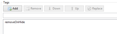

Did you try to add the "removeOnHide" tag to the parts you're removing in the Application.e4xmi?
index.php/fa/24268/0/
Re: Parts from a perspective that is not active are not closed [message #1717152 is a reply to message #1716092] Thu, 10 December 2015 05:16 Go to previous message
